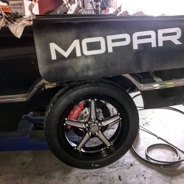

Got a 26” on mine with a 17x4.5 wheel, looks good but no performance data to share yet might end up going bigger.
