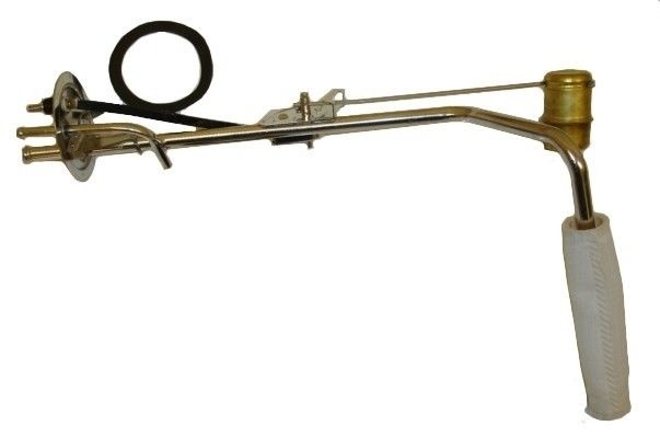

Does your sending unit look like this?
If so, you'd want to use the smaller inlet on it for your fuel return.
If not, consider getting one like this.
Alright, it looks like I'll have to get a new one then. Mine only has the main line. Thanks moparedtn!
Just take your sender off, drill a hole and install a fitting or nipple. You can solder it on to seal it.
I removed my empty tank, drilled a hole, and installed a bulkhead fitting for my return line.
