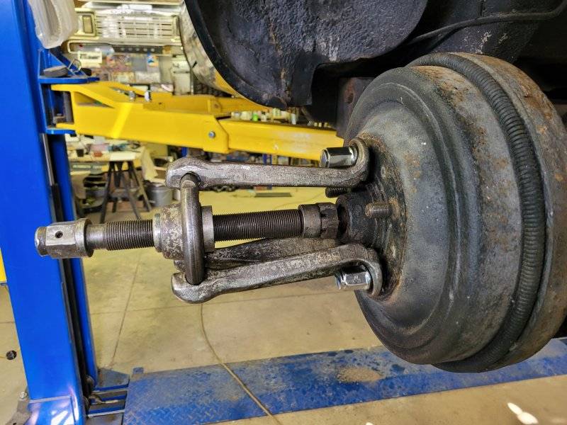

Take one rear wheel off and look at the end of the axle. If there is a big nut it is the taper style.

No need to take the drum off to see what you have! The nut holds it on!

Pull a rear wheel off (if you had steel wheels, you'd only need to pull the hubcap or wheel cover. )
If there's a big nut on the center end of the axle, it's most likely the original 62 rear.
If there isn't one.... it isn't.
If it's really got 11" rear brakes, I'd bet against it being a 62 rear.
