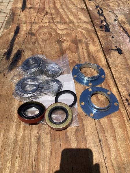

Yukon Gear has a bearing, seal, retainer, adjuster package. Timken bearings in the package btw. Scored one to replace the Greens installed by the PO. Since I'm not sure if he pulled the buttons out of the carrier, I bought a set of those too in case they're needed when I take it all apart.
