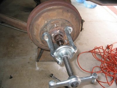

This is the tool you're looking for. I found one on Craigslist 2 years ago for about $60.00 but they also become available on EBAY from time to time. The prices I've seen on EBAY are in the $100 range, depending on the condition of the tool.
I think it is to pull the drum and not the axle. The drum is already uninstalled. So I need the one to get the axle off.
