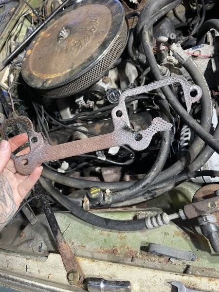

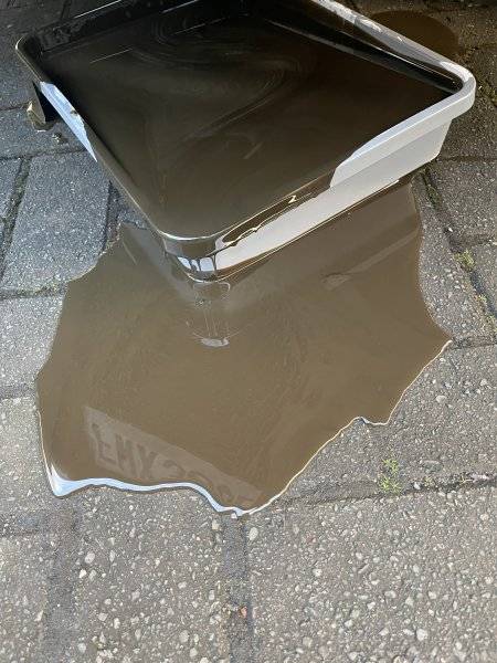

i checked for puff of air when starting the engine and thought i could feel one so swapped the gasket which deff can’t have been doing much as it looked like this! going to do an oil change and try starting again and hopefully the noise will have gone
Looks like you found your noise. :drinks:
When you do the oil change a new air filter element would be good also.
When they get real bad it cuts air flow and can cause a run rich condition.
