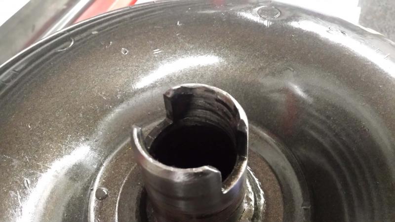

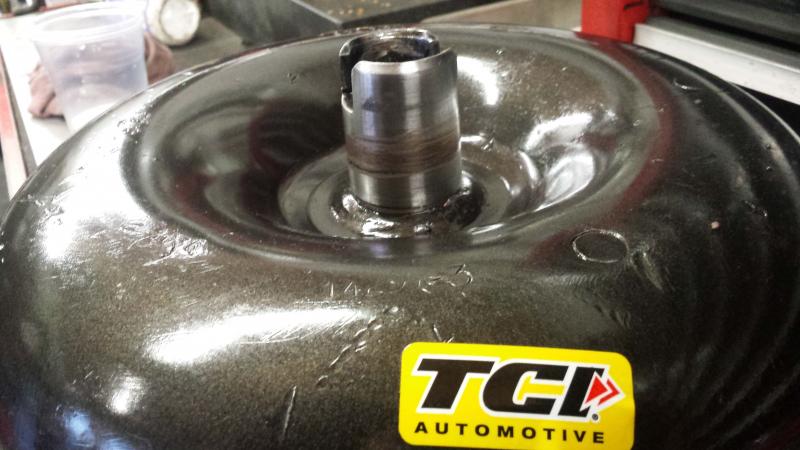

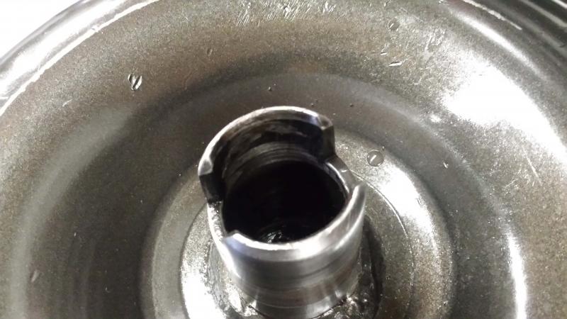

some pictures of the A904 after less than 3 minutes of engine 73 Saterllite new wheels.jpg1973 SSP torque converter 2 4.18.15.jpg1973 SSP torque convewrter3 4.18.15.jpg1973 SSP torque converter 4.18.15.jpgrun time. no drive time.

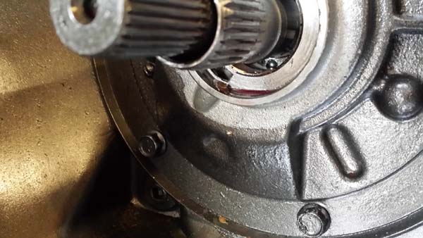

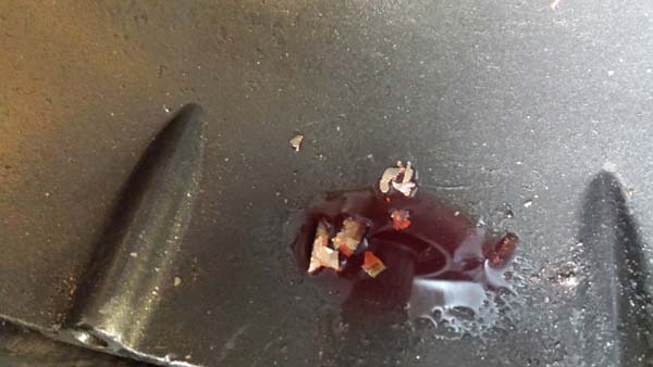

A few more pictures.73SSP main shaft 4.19.15.jpg73 SSP metal below shaft 5.4.15.jpg73 SSP trans metal chuncks.jpg
Pull front pump. Replace front pump bushing. Get new chromolly snout welded on converter. The 904 in basically stock configuration will do fine up to about 450 hp ish

Once the trans has been removed replacing the pump bushing is less than a 30 minute job. I prefer babbitt bushings. We just killed one in my sons turbo car. It had a babbitt bushing, no converter damage. to bad you don't live in Michigan I'd handle it for you. Maybe another member that lives close? It's really not a big deal.

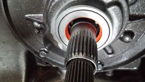

My nephew and I spent about 5 hour installing 727 trans from TCI fallowed the instructions that came with the trans. fired up the engine and ran it for 20 minutes to break in per Hughes engines. then spent 5 minutes adjusting the timing and carb to get things close after 25 minutes of run time the trans started leaking oil from the front. shut it down and put it on the lift to check it out. lower it down went to start it and it would not start figured out only getting 6 volt to the dizzy MSD need 12 volts. so we pushed it to a parking stall and called it a night. I stopped by my nephews shop Tuesday after work to see if he found anything out. so we where going to push it closer to the door so we can charge the battery and I figured I would try to start it and what you know it started right up let it warm up couple minutes and decided to drive over to the door and oil started pouring out of the front again. not sure exactly what is going on this is the 2nd trans from TCI that is leaking oil from the front. The engine was balance with the flex plate when it was built. does anybody have any idea why it would leak oil from the front seal. The only time I drove the car was to move yester day.
