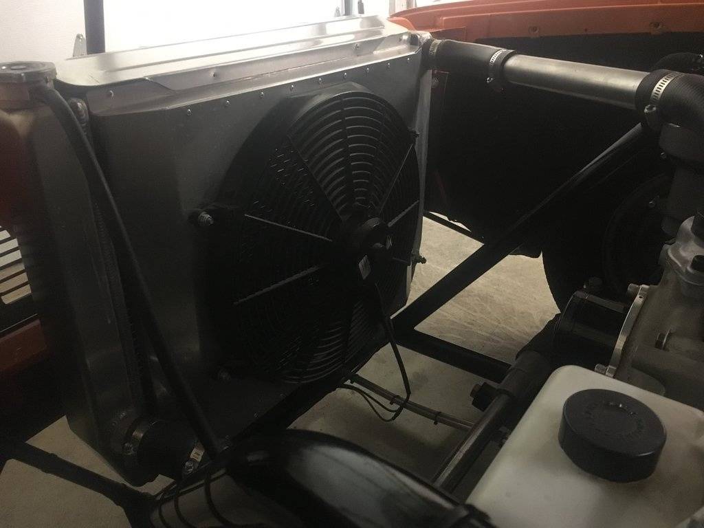

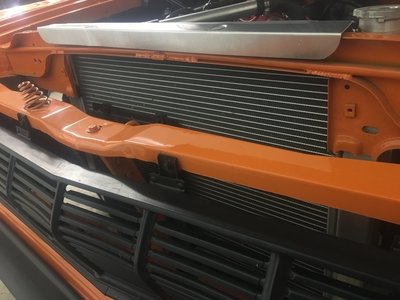

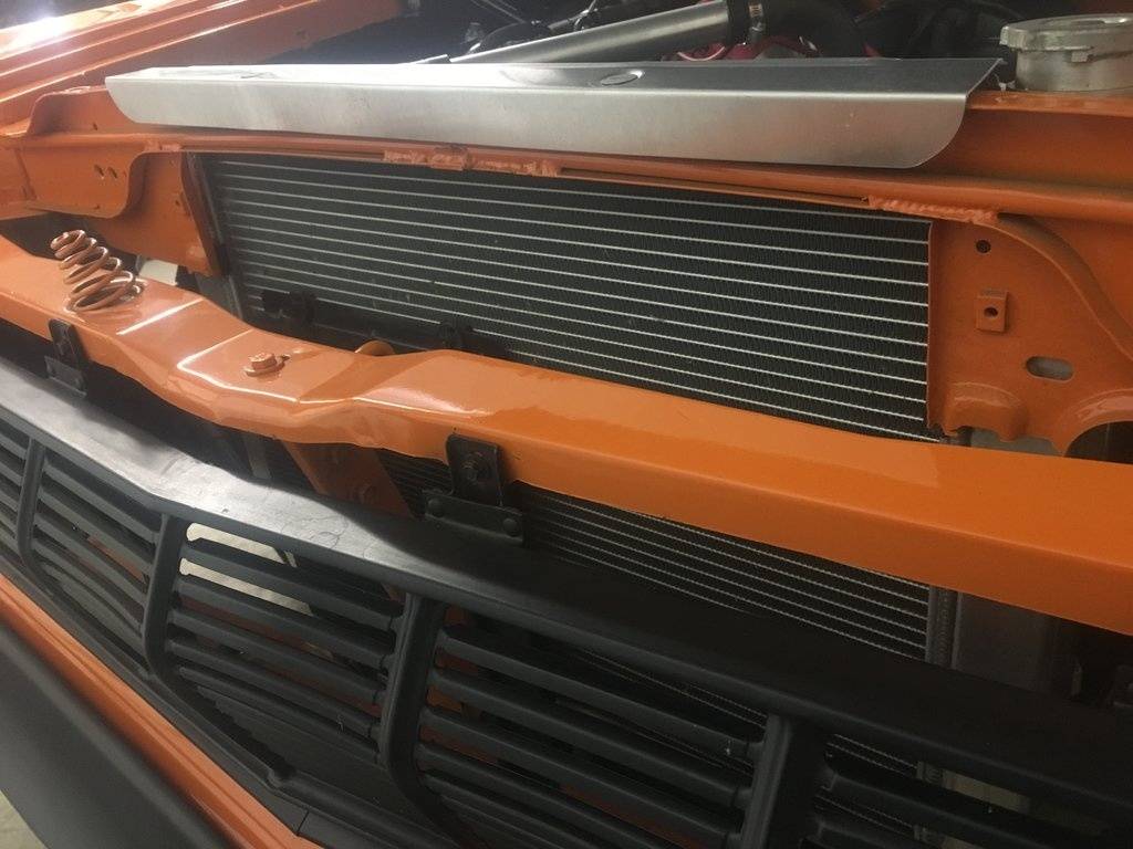

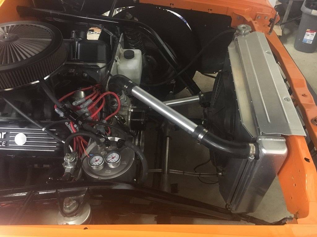

Here is an idea of what I'm working with
I don't think your engine being further back will have any negative effect. Airflow over the engine from the fan is negligible, does not matter. However, the fan should be pulling sufficient air through the radiator which pulls the heat out of the coolant. I've heard plenty stories of those 3 and 4 row radiators running hot due to the air getting trapped in the middle and not allowing good airflow through the core. The least amount of rows with the biggest tubes will work the best. The object is to pull the heat out with airflow, lose the airflow and the heat will not leave !
