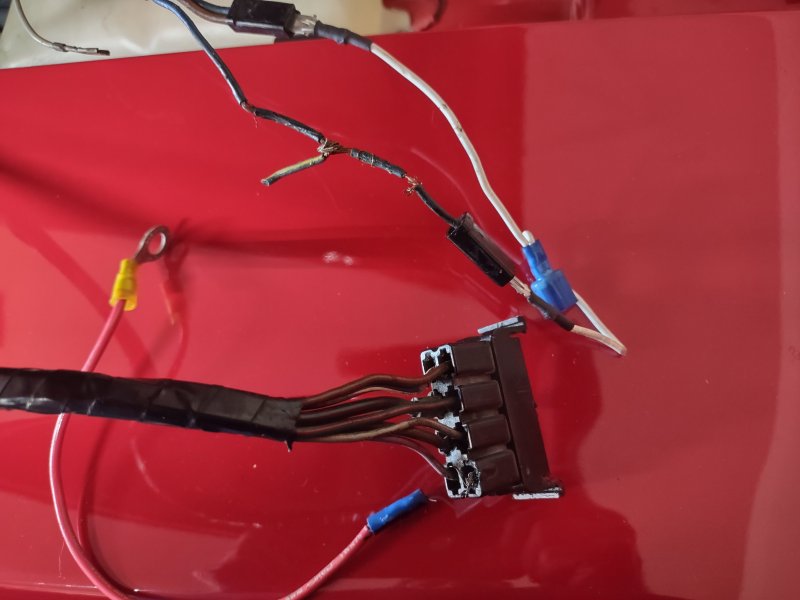

Taking a break from dash as I'm waiting on wiper linkage bushings. Decided to address some hacked up wiring under the hood. Didn't realize it was this bad, everything covered up up with ugly wire loom and tape. Who does such shoddy work???? It's a wonder this car didn't catch on fire. No fusible link just wire barely crimped wth butt connector. You can see evidence of connecter starting to melt. Needless to say, new harness on the way. Any ideas on how to clean bulkhead terminals? I was thinking of using some jewelry cleaner which has a mild acid in it, but not sure how to rinse it after, maybe contact cleaner? Any ideas? Thanks!!!

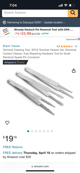

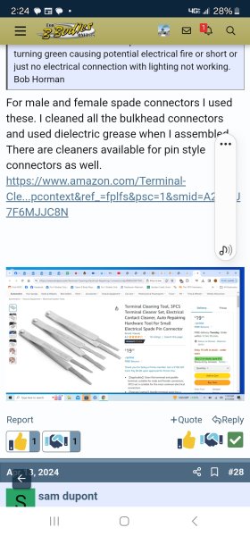

I'm working on replacing my engine and forward light harnes, did a search on FBBO how to clean bulkhead connector. Found a thread that recommend these so I ordered a set.
Thanks, how do you clean the female ones in bulkhead, can they be taken apart as well?
Someone posted on here a special two sided file. I should have info. goes to original poster. I believe it’s on Amazon

I have seen wiring like that quite a bit.
Sometimes a little bit of knowledge can be a dangerous thing in the wrong hands. :rolleyes:

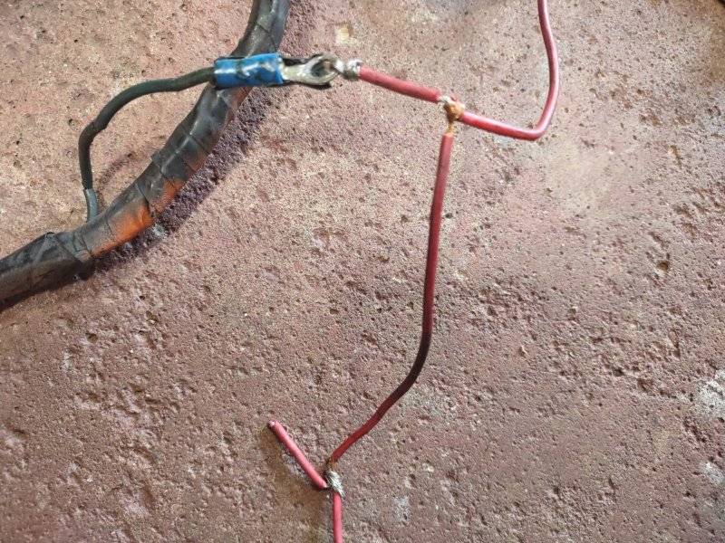

Last weekend I pulled out my old engine harness, wires so brittle the insulation cracked each time you touched. Lots of splices and patches. I'm amazed the car ran so well.
