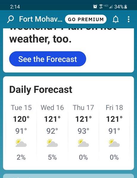

Well I'll finally get a good test of my cooling system and a/c next week. 110 last week and did well. Had a 115 day last yr w electric fans that did well in slow traffic and idle but horrible on interstate. But next week I finally get a real world test of my mechanical fan and factory shroud.

Here's this week's temps. I'll be taking her out around 3 today to see how she does. Engine temp, a/c, stop n go n highway. Will update later.
