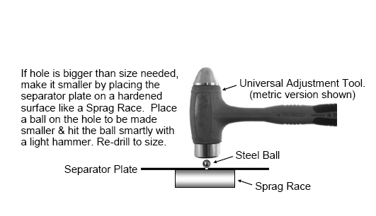

As per Transgo, to smoothen the 2-3 shift you can reduce the port diameter on the port "C" on the separator plate, this will reduce oil flow and smoothen out the 2-3 shift.
Below is what i followed by using a small steel ball and reduced the hole size a little bit.
