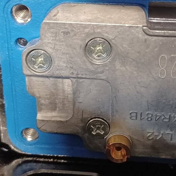

It was running very very pig rich. I just didn't want to blame my new carb, but after talking to Holley, they recommended I look at the carb. Ended up the plate in the secondary, behind the bowl was never torqued.
Totally solved the probem.
