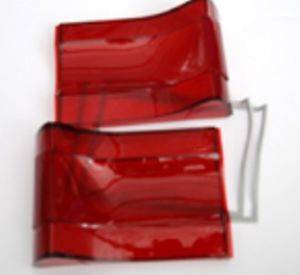

Did you notice the tail light lenses, no grill work, something's just not right about this whole deal!

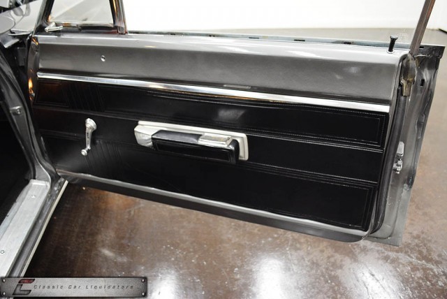

the doors panels are just awful and did anyone notice he is using a drivers side rear armrest on the passenger door you can see the ash tray
Actually '67 GTX Tail Lights do not have the grill work in them. '66 Satellite Sports did. And those tail light lenses and the bezels are for a '66. Totally wrong for the '67. This to me looks like a "HACK" job to make something look correct but is not. The VIN is actually for a '67 GTX as I ran it through MYMOPAR dot com and it came up as such. The interior though is a total hack job and as said before had they taken the time to come up with the correct interior pieces, then it would be a great buy. Just sad how no one at the eBag will monitor the listings for accuracy and correctness....cr8crshr/Tuck
Console, seats, door panels, trunk paint, Corporate Blue engine block and valve covers, and more. Wrong t/light lenses.

Left is '66, right is '67.

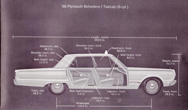

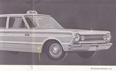

66 Belvedere. Not sure I've seen one of those either. Was that an RE VINned car. Got any info on them?
The '66 Belvedere Police and Taxi (VIN RK21/41 & RT21/41) and the cop wagons (RK45) were sold as plain Belvederes in the Commercial brochures, and are counted as just plain old Belvedere, versus Belvedere I, and are counted separately from Belvedere I production numbers.
The 1967 Belvedere was indeed VINned as RE; and from my info sources, the RE cars were all six-passenger station wagons. Belvedere I was RL, like the '66 cars are.

They are counted differently, and are considered Belvedere in production numbers. I've not seen that particular pic before...interesting...
My bad!!! After reading again it actually refers to the Belvedere/Satellite as having the "Sport Trim Package". As we all know "Assume" is the operative word for my mistake and I fell like an...
More like the second pic I would suspect. But the first? VaVaVOOOOMMMM!!!!cr8crshr/Tuck
