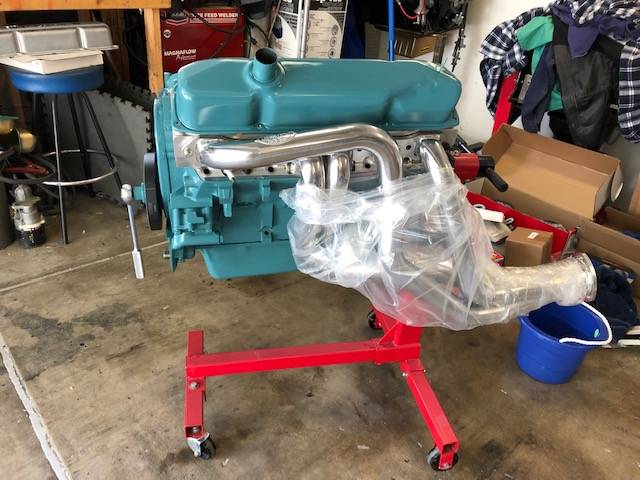

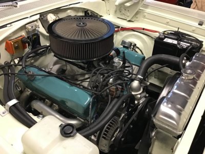

Doug’s 2 inch fit pretty good, and are built like a tank. I did have to clearance # 1 at the torsion bar, and # 2 touched the shock tower when I got on it. They fit angle plug heads great! From what a I’ve seen tti’s might fit the best. My car is a 66 Coronet 500 with a 440.
