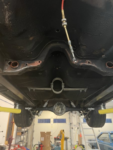

I have the original 8 3/4 rear in my Belvedere. I haven't seen any place to cut weight there besides getting an aluminum center section. There is my aluminum wheel cylinder project, but that hasn't produced anything viable yet. Up front, I have looked closely at my upper and lower control arms. I don't really see any places to reduce weight there (holes) safely, so they are stock. There are aftermarket, tubular pieces available, however the ones I have seen so far weigh more than the factory pieces. I am looking into some titanium fasteners to replace some of the steel hardware, but the main parts remain stock.

Never did spend much on my cars....and got my 66 Belvedere down to 2950 without much effort. It started out at 3370 and the 2950 figure still had the stock front end and K-frame along with the factory working AC still on it. It also still had the 15x7 cop car wheels. Just wish I had kept the AC setup as the car won't be used as a dedicated race car anymore like I had in mind several years ago but can always install an aftermarket kit. And if you're wondering about the 3370 figure.....it was a /6 auto car but was at the track with it anyways. Went 7 rounds with it one night and there's nothing better than being the underdog lol but, going that slow isn't all that fun.

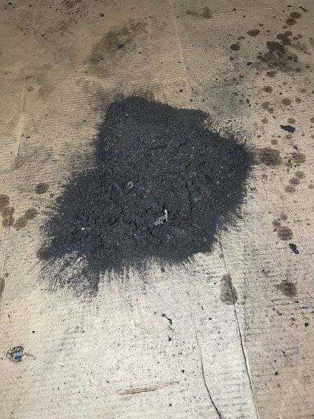

This pile is the remnants of the undercoating that was removed from my Duster. The whole job was done with a torch and scraper. Whatever residue left was removed with Goo Gone. I have a lift so thankfully I didn't have to lay on my back to do this but it was still a tough, tedious and dirty job. So many hard to reach spots and uneven surfaces, it almost got the best of me. I made sure to try and capture every single bit that I could to be able to weigh it at the end. Including both wheel wells, the grand total was 12lbs.
You read that right - 12 FRIGGIN' POUNDS!!! Took a while to swallow that. I'd read many times where guys were seeing savings of well over 20lbs. I have to question the veracity of some of those claims because this car had the full Monty job and they weren't stingy with it.
I detest working on rough, dirty surfaces so the main goal was to clean the underside with the added benefit of removing a nice chunk of weight. Got one out of two...

I beg under oath that my cars dirty under sides were heavier than even 20 Lbs. I've got it written down somewhere, but unfortunately not in my master log.
I know that b-bodies are not that much longer or fatter than an A body, but it could be applied thick or thin depending on dealer order, sprayer behavior and the actual formula of the stuff. Not sure if coatings differ from dealer to dealer or brand to brand.
I've noticed over the years when helping some guys with the removal that some undercoatings were dry and flakey, almost on the verge of being dust whereas other were thick and almost feeling wet, like new asphalt tar. I mean chunks that looked like parts of a meteor. LOL

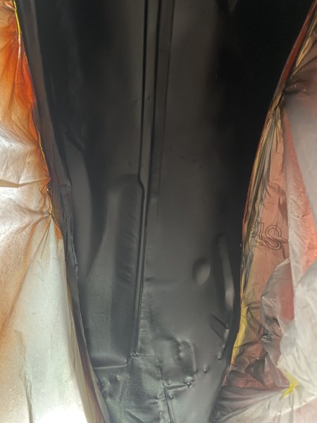

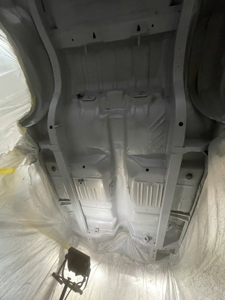

Here's a before shot. This was a combination of still flexible, tar like stuff and dirty, crusty dust. All of it sucked.
This is after removal and sealed with a couple coats of PPG DP90. The underside of this car was spotless before the epoxy sealer. Probably added 2lbs back with the epoxy. :screwy:
I used thinned out Raptor Liner to seal the wheel wells to retain a quasi factory look. Yes, the wheel well is pounded out on the left side above the lip for tire clearance. This is two thin coatings. The thinned out Raptor Liner has some texture but is not rough like the factory undercoating.
