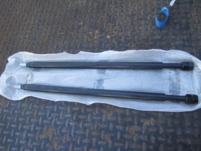

I still have a few lbs to shed. Been sitting on a pair of black powder coated aluminum strut rods but not sure if they would stand up to my street driving.
What do you guys think??
The factory original ones I took off my Duster were bent to **** and they were steel.

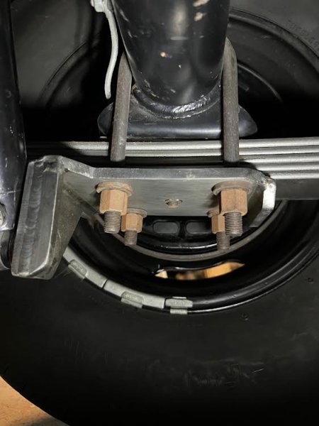

How's these for measure? Shock/spring plates.
Titanium is extremely hard to drill through and cut and never mind trying to bend any of it, for it will bend your brain and your patience for sure.
My welder guy who is well into his late 60's is a certified military and space industry welder. He welds components that are classified in a designated area of his shop and he doesn't allow me to see any of it for obvious reasons.
He loves working on this earthling thing not only because I bring him the craziest ideas, but I bring him even crazier homemade jigs that hold what ever it is together while he runs the beads. It brings a smile and a laugh to both of us when he just shakes his head and is impressed. LOL.
What's crazy is that pretty much all of the jigs that have held things true or in place have been with stuff found on the street. The secret is meticulous measuring.
Anyway, the Stockers were 6 Lbs.
Titanium units were 5 Lbs. 1 lb saved.
This is off course without cutting off excess end of threads U bolt material. Titanium nuts have since been ordered.
The shock stud is titanium and both pressed on and bead welded.

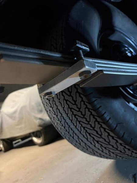

Here's the spring clamps in position as they came with the leafs, but the bottom sandwich bars are aluminum and the bolts are 6AL4V Titanium. The top sandwich bars are steel. Saved 1-1/2 lbs between all 6ix of them.

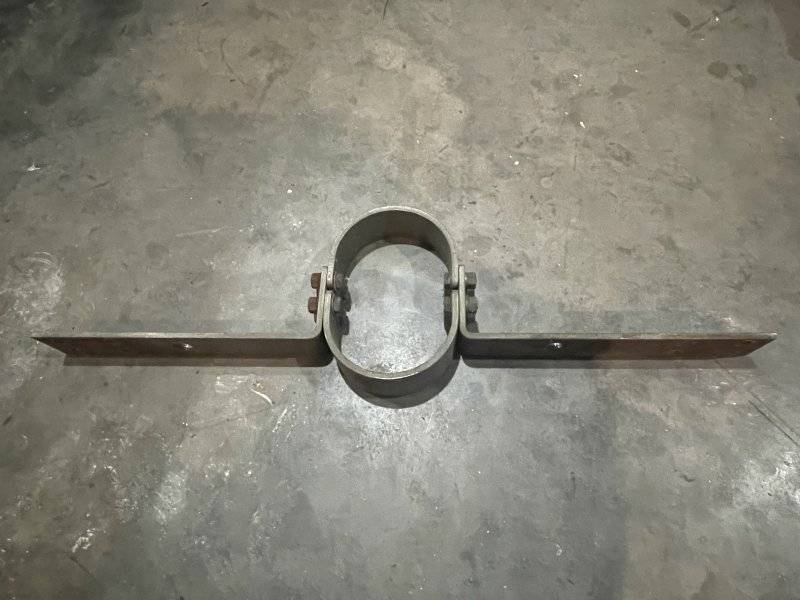

Also just to follow up on the driveshaft loop, it's not 15lbs, not even close. It might be 5lbs if that. When I took it off to do the undercoating it seemed really heavy but in reality it's not that bad.
I have no plans to drill any 'speed' holes in it though since it needs to withstand some pretty blunt force should a u joint give way. There are two extra holes in it already for seat bolts but that's as far as I'll go. Best to leave it as-is to ensure it does it's job as intended. The previous owner did cut the top edges off the "L" parts that bolt to the hoop sides so there's the weight reduction.
Welding the pieces together does not seem like a great idea either since the hoop bolts hold the halves in shear. Even if the holes were to stretch on impact they shouldn't just snap off like one of my poor welds could. Plus, there's eight of them. Shaving the weight of eight 3/4" length bolts is not worth the potential pitfalls of the alternative.
This is an old part that was on my car when I bought it but I never really looked at it too closely - it's a driveshaft loop. I didn't even realize it had a zinc coating on it because it was mostly hidden by oxidation. The whole works was submerged into an Evaporust bath to clean it up. The Evaporust removed most of the remaining zinc coating so I'll have to paint it now but it's good to go otherwise.
