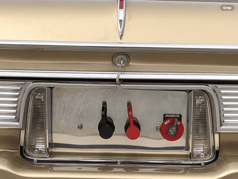

Is that trunk key aluminum. If not it should be. LOL.Back up lights and some Fury trim to boot over here, but weight is in a good place.

Haha I will be checking on that key..Is that trunk key aluminum. If not it should be. LOL.

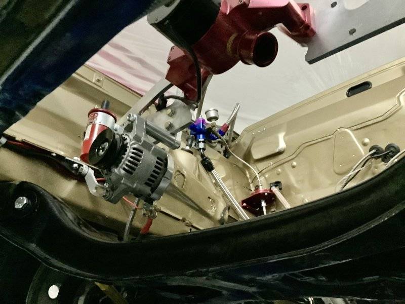

And the weight hunt continues. It’s addictive. Today a guy spent hours on a different alternator bracket. Gone with the steel one. The savings, 6 ounces. A measly 6 ounces…. Addictive all right.

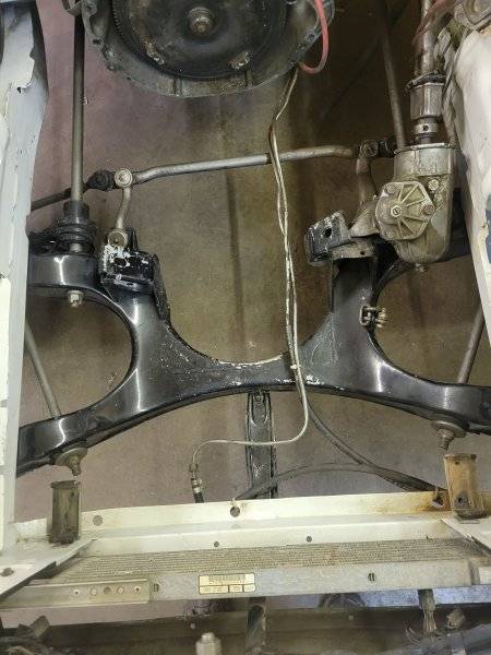

Pics of the k frame? Those lips are worth alot poundageHaha I will be checking on that key..
That sure leaned things out.Pics of the k frame? Those lips are worth alot poundageView attachment 1582298

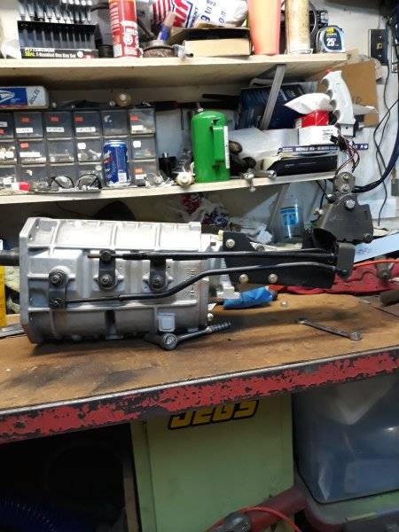

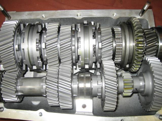

That should just about make up for the additional bar weight. Nice trans!The race 5 speed is going back in to replace the iron street Hemi 4 speed. Almost 30 pounds lighter.
Liberty does nice work.It started out as a Richmond street 5 speed and I had the gears Face-plated and cryo treated by Liberty's
It shifts like butter at full throttle with a Long V-gate shifter but I'm running an H-pattern shifter for the street.Liberty does nice work.

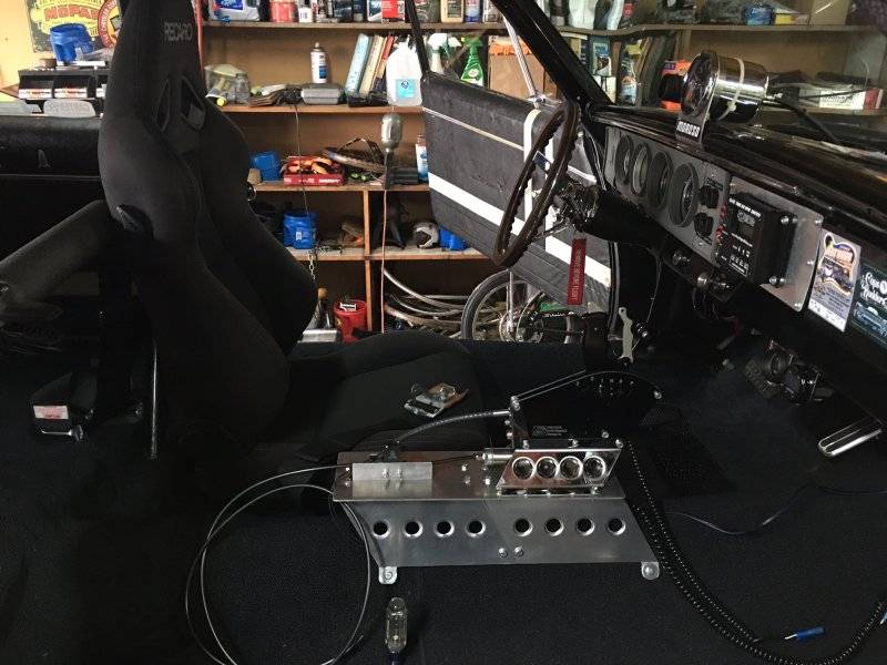

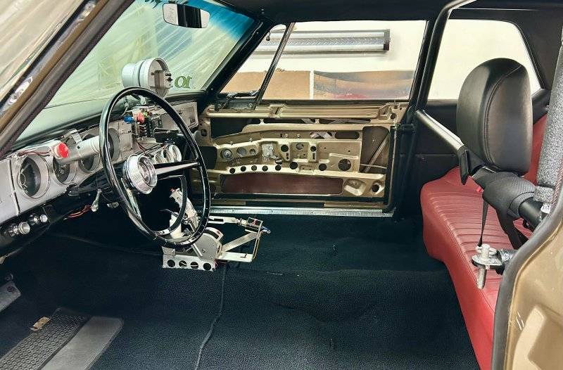

hey nice looking shifter and stand,,Well another day and 3 more lbs came off the old Plymouth. That’s about it, there’s no more getting to be got. That is unless I want to start pulling out window regs, seats and glass. That’s not part of the plan though. My car is legal to go 10.00, that is all I want out of it. It’s been at that point for a few years now. I’ve removed 75 lbs of weight this off season now and with a fresh motor next season I’m sure the 9’s will become an issue even with the full interior. With the new addition of the electric shift however, I’ll preset the shift RPM during elimination so that I stay on the safe side of 10.00.

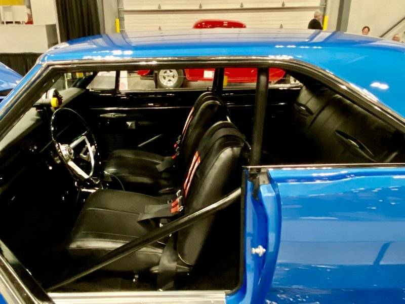

The interior is going back together. And a look behind door #2
FMJ touched on the Plymouth looking like a lightweight on the outside and that’s true with the Super Stock looking grill. As well there will be the 3” Hemi scoop new to the look in ‘24. But certainly not the inside though. It’s all about what I like.
The same holds true for the Dart and it would have been easy to make it a clone L023. But it’s a one man operation here and what I like is what you see. LOL.
Besides, I doubt that Houdini couldn’t get that rear seat back out of there.
