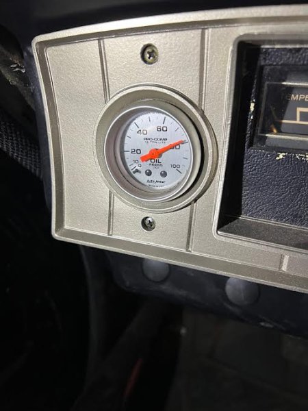

I might have posted this years ago, but a recent conversation with RMCHRGR concerning gauge cluster panels, triggered my attention on how heavy some gauges can actually be. The numbers are not in front of me at the moment, but the difference in the weight of a regular steel cased 5" Monster tach and a Pro Comp Uni-lite Monster tach really revved me up. I'll have to look it up again, but roughly 1/2 Lb difference.
The tach, along with all the other necessary dials factored in, shaved off almost a whole pound total. That was good enough for the piper.
Other than the Ultra-Lites, I'm sure there are now other much lighter instruments available in the open market, but at least they are a good affordable starting point.

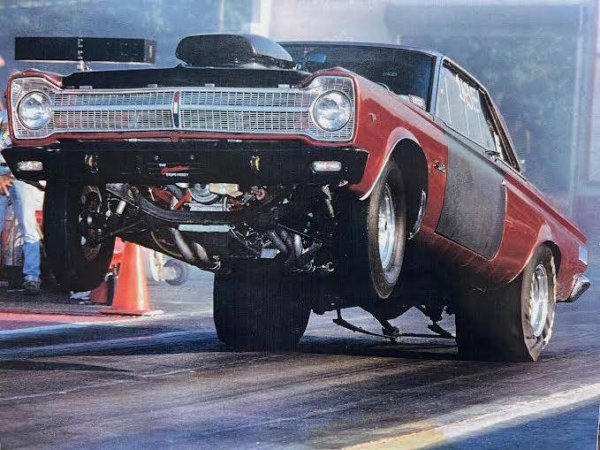

A little deviation from the actual black art of weight reduction is this Brooklyn based street racer. I assisted in giving the owner a few pointers to get this thing under 3600 Lbs, (suggesting doors, Hood, front bumper, and actually installing the side Lexan glass) but it never quite achieved real feather-fitness like I would have liked because he was more concerned with the break throughs of the elephant huffing underneath. Can't blame him because the car even though still heavy, held its own (UP HIGH).
It ran like stink and ran on the street for nothing but $$$$$ Till this day, I can't really land on his numbers, but they were in the single digits while looking at Elvis in the next lane.

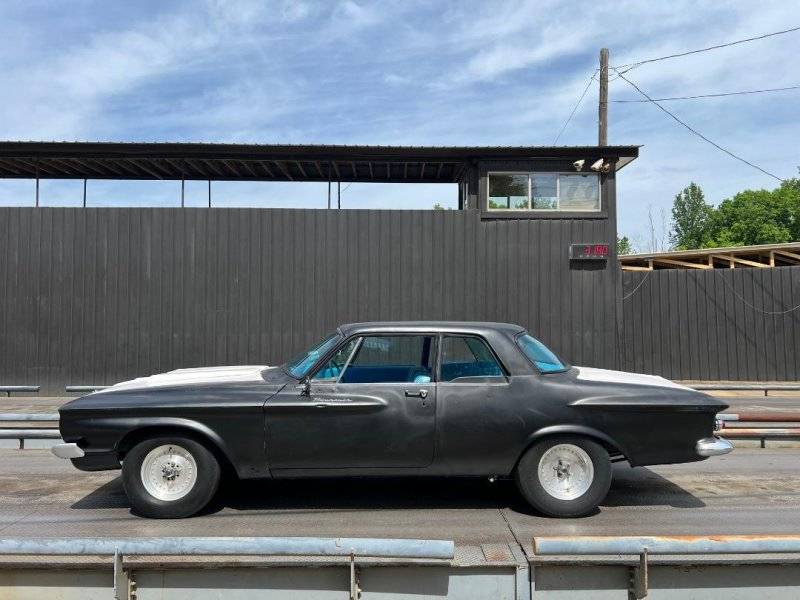

This here is one helluva super light package. 1962 Savoy.
I'm not sure what has been done to it to bring it down so far, other than what looks like a fiberglass hood, trunk lid, centerline wheels and perhaps a fiberglass front bumper, but I am sure to know soon. It looks to have a full interior by what this image shows.
This ex Brooklyn patriot has Been building it for the last two years.
Ready?........................ Full tank of gasoline, two batteries and a heavy (Truck) Dana 60........................... 3180 Lbs.
My other friend with his factory '62 Max Wedge Savoy is 3395 Lbs. All factory steel, interior and glass.

Both those 62's are lighter than my sons. But probably no roll cage or subframe connectors. I think Scott's with out him is a little over 3200.
Doug
My friend's '62 Maxie is as virgin as they come with the exception of the 15" steel wheels and tires in place of the 14's, 833 4 speed in place of the T85 3 speed.
Heavy cast iron MW swoop horn exhaust manifolds and all original NOS MW exhaust tubing and MW mufflers reside underneath.
I don't remember how much fuel it had in the tank when we weighed it on my 4 wheel digital scales, but it never had frame connectors nor a roll bar/cage to this day. It even has the original steel L shape tow tabs out front under the bumper.
Special K, its owner, always tells me that I started with the wrong car.
I wouldn't dare to persuade him to perform a few lightweight tricks since he would have my head on a platter and he wouldn't touch it with a 10ft feather. I don't blame him since its racing days are long gone and it is a genie Max wedge at that.
Now looking at that image above of the flat black spray painted '62, I wonder how accurate those truck type scales are or how far he went underneath the skin to get it that light.
