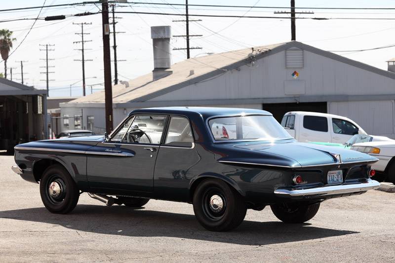

Now that Mosher has retired in his later years, and rightfully so, those mirrors are going to be back in stock and ready for shipment. He must have bought out every mirror on the shelf just to supply his armada of Super Stock creations. Beautiful cars.When I had my '65 Belvedere post car I leaded the mirror post holes shut and planned on using one of those clip-on peep mirrors for street driving. It can be removed easily enough should the need arise.

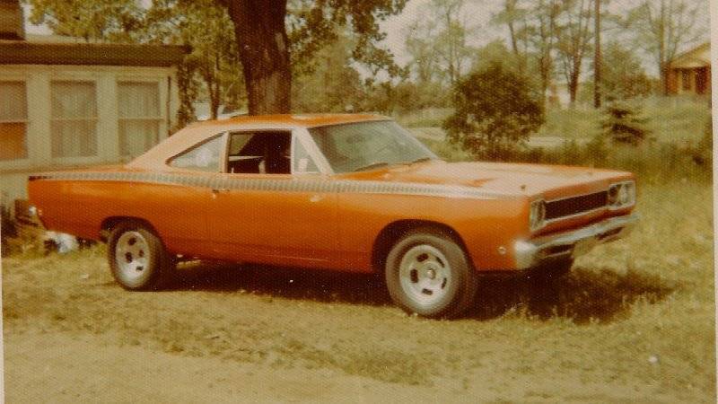

That's quite impressive on both the fronts of ET and weight achievements. A 383, even at 0.60 over is a hard beast to get going unless with a good shifting 4 speed, stiff gears outback and spinning at heavens gate RPM's. What probably helped you immensely was the lack of carrying fat.I went too far on my '68 Road Runner but my best time 383 (bored .60 over), four speed crash box, Lakewood scatter shield, 8 3/4 rear end, 2" hooker headers, stock heads that I ported and polished myself, Edelbrock Tarantula manifold (NOT torquer), battleship springs, single 4 barrel carburetor, normally aspirated with NO NITROUS!, Ran Holley Dominator with 98 jets in secondaries, Stewart Warner manual 4 to 1 tachometer for 100% accuracy, clutch was 12-400 pound ford truck springs. Suspension 9-10's front, individual controlled air shocks rear. I got it down to 2,690 pounds! No window mechanisms, plexiglass side windows, no hood springs, homemade fiberglass hood with 4 hood pins, removed 2 inner headlights, scrapped every bit of undercoating off, drilled 1/4" holes everywhere it would not show, like doors, rear door panel area, light weight sheet aluminum sheet with glued vinyl for door panels. I had fiberglass racing seats, no back seat. No holes on brake parts or frame. Cut out steel under seats, replaced with aluminum pop riveted in. Removed backing and insulation from carpet, battery in trunk. 4 gallon dragster tank in trunk. My best time was a 10.54 at Spokane Raceway Park (2350' above sea level), which I backed up with a 10.44. I was power shifting at 7,500 RPM. I built the engine like a Chevy. It had stock rods which I hand selected and polished, after magnafluxed, then I balanced them.

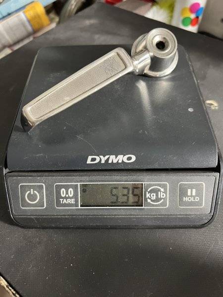

in the end it all adds up
