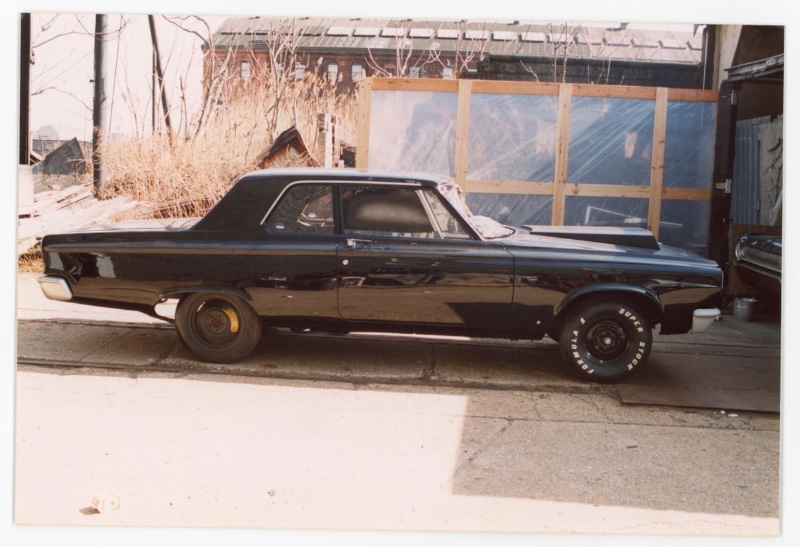

Here's the side profile mug shot showing the rear wheel alteration forward 2". Yes, the Three Card Monte worked at the show after all these years. This was back in 2000 when things were still hot and active.
Wow, that is so subtle and sneakily done. I never noticed the axle reposition. Was the fender opening moved? Nothing looks even remotely altered. Beautifully done (of course).
This was of course with a pair of rollers used during painting. With the actual race wheels and tires, it's unnoticeable. Wheel well at the very bottom needed very slight clearing shave to clear the 28" by 10.5 Hoosiers. Engine setback is 4" up front. The front wheels are in stock position. Pretty much almost a 2% setup like the original four cars, but more stealthy, especially in the dark.

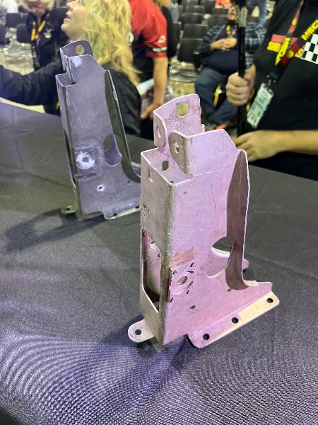

I'll keep it short in that I was completely blown away when these two specimens made their way to the stage on Saturday during a seminar involving old school Chrysler racers and builders.
Exhibit # 1 shows two brake bar harnesses which are found underneath the dash. Both Aluminum and Magnesium counterparts in this case, but steel versions are the norm, so of course y'all know where I went with that. And here I thought I had everyone beat by a mile with my own version.
After that seminar, what I walked away with wasn't just amazed envy, but the notion that any myths or legends heard of in the past could quite possibly be true. One just has to patiently dig deep or be patient for the items to come to you.
Anyone ever hear of Titanium torsion bars? More on this coming.
