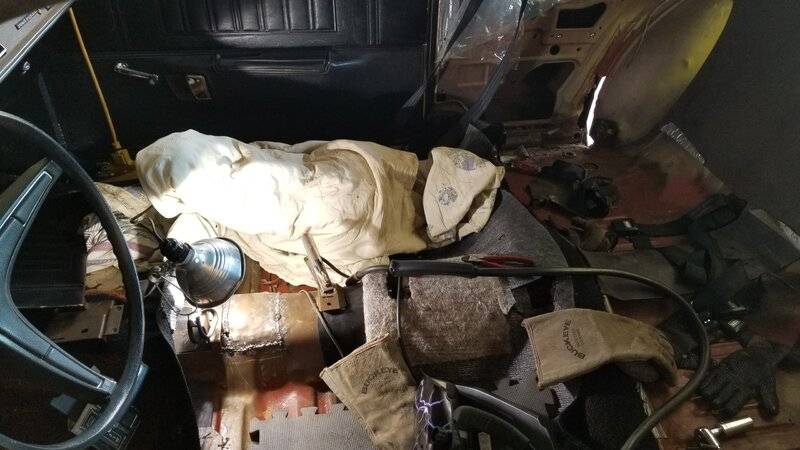

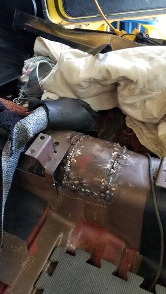

In the mean time, I welded up the transmission tunnel. To keep it from warping, I welded it with tons of little spot welds. It looks like crap, but it is solid, and I used a light to find any small holes that hadn't been fully welded.
Some time in the future I will grind it smooth and make it look nice, but (1) it is under the carpet and console so it won't be seen, and (2) below is what my car looks like only a few days before we are scheduled to leave.

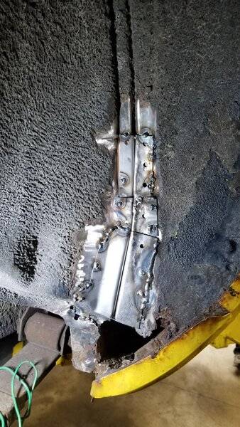

Notice the bright light in the upper right. Just like on the driver's side, I found rust on the passenger side in the wheel well. I went after it to get rid of all the rust, but that has left me a gaping hole. Time to get out the welder and start welding pieces of metal back in to repair it.

So I've been grinding, bending metal and welding today. A lot! :BangHead:
First of all, I am no bodywork guy. But I have bent and tack welded 7 different pieces of metal to replace what the tin worm has eaten.
There is still a lot of work left. I have to clean up and weld in a triangular piece on the bottom. But mostly, I need to add tack welds all the way around, as well as finish filling the plug welds. Then I will grind like a madman, weld up remaining holes, and rinse and repeat until it is smooth, blended in, and solid. Finally, I'll spray some undercoating to hide whatever sins my shitty welding and bodywork have left.
It most assuredly won't look perfect, but will hopefully be passable and it will be water tight!

Today I spent welding, grinding, welding, grinding, etc. until there were no pin holes left in the rust repair area. It was a pain because some of the metal was thin and in some cases I blew through the metal. My welder only has for distinct settings, A - D, and no settings in between. In the B setting I blew through easily, and on the A setting I didn't feel I had quite enough power to weld well. So it fought me, but I finally got it all welded up, and (somewhat) ground down. Then I covered up my sins with copious amounts of undercoating!
Here is the final result. No it doesn't look factory, but hopefully it doesn't look so horrible so as to totally detract from the area in case someone chooses to remove a wheel and inspect the area! :poke:
Most importantly, I feel fairly confident that the leak has been addressed. Now to wait for my axles, and hopefully on Wednesday or Thursday I can get get my axles and get them back in the car.

BEEN THERE, DONE THAT TOO HAWK!! Welder same, A not enough, B "HOLES", learned how to fill holes, KINDA!! UUUGGGLLLYYY!! Underside of floor looked liked Crystal Cave with all the slag-tights! No water leaks, JOB DONE, GOOD TO GO. Panel bond WAS my friend. Can't see your patch job from Oklahoma. I'll show @eldubb440 the pics, so be ready for razzing, when I see Mark.
