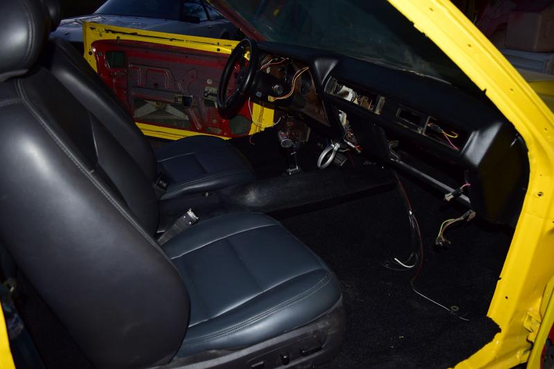

Hey guys! Overdue for an update, sorry been busy in the shop. My car is home now from the paint shop! Ive been spending a lot of time putting it back together. The carpet, console, dash and seats are in! Look's pretty good but with the flash on the replaced seat bottoms color difference really stands out.. :angryfire: Gonna have to dye them a little darker to get a better match.

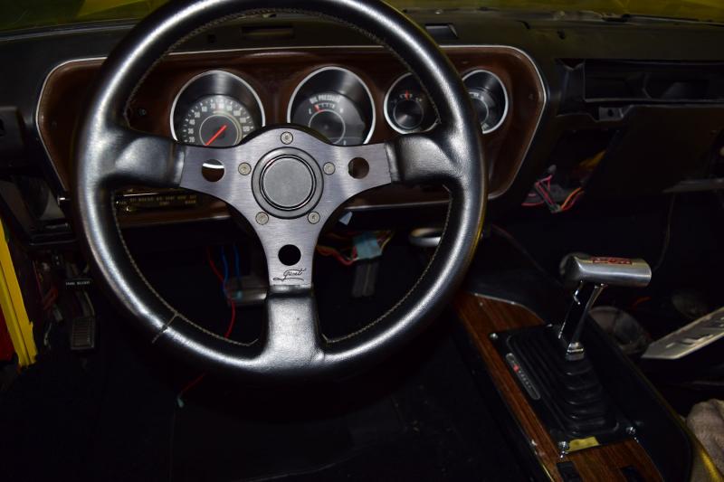

I also swapped out the case on my steering column to get rid of gear indicator and shift lever.

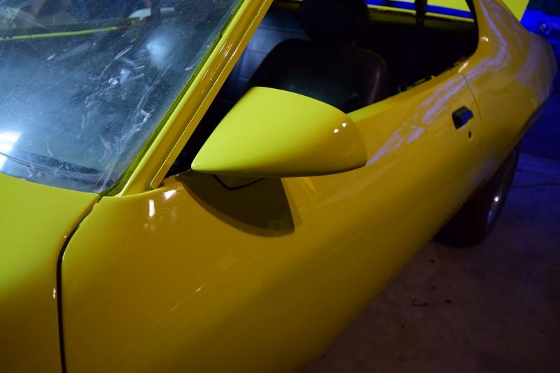

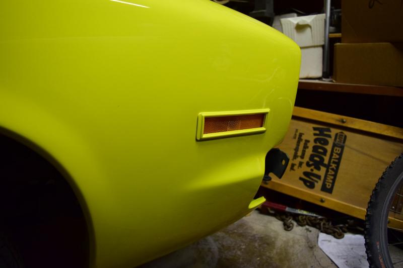

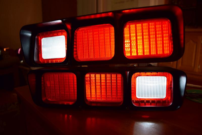

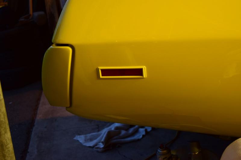

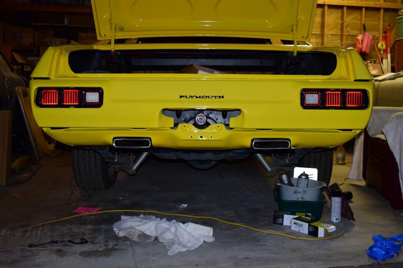

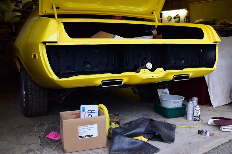

Been doing some exterior work too! Door handles are on, marker lights, drivers mirror, and the rear bumper and valance. I put LED's in the tail lights, they look awesome buttttt arent working properly, when I turn on the indicator everything flashes, both turn signals as well as all the marker lights.
Bm02tj hoping for a simple fix. gonna check the new bulbs and grounds. they all worked last time the car..

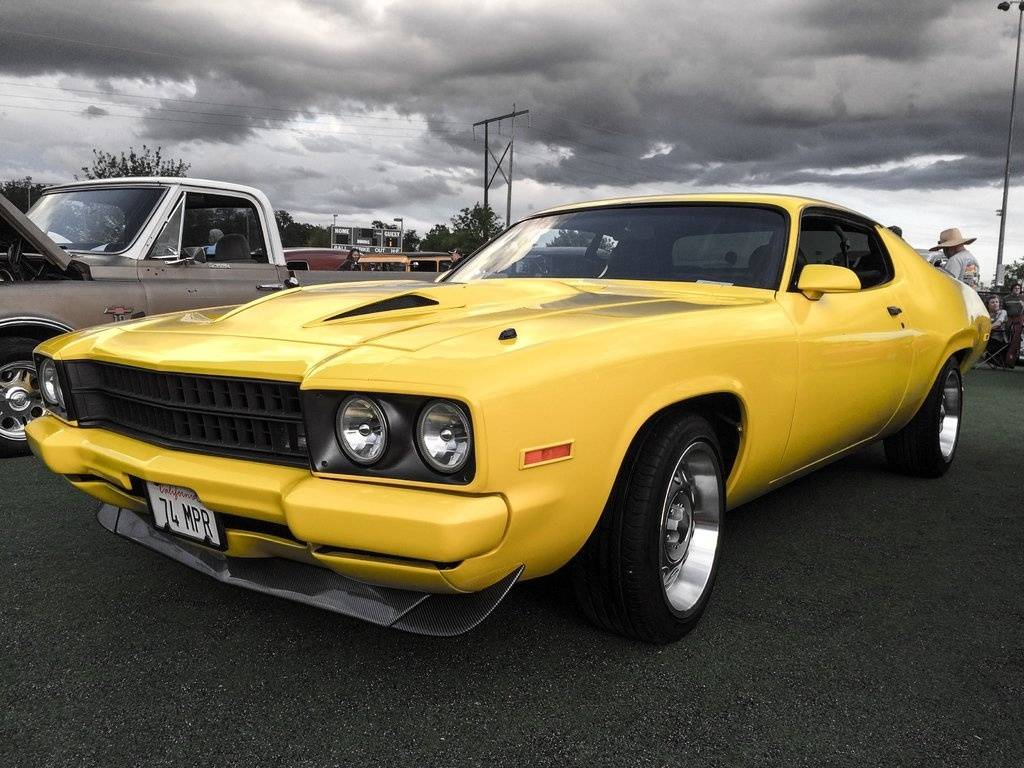

Been a while since ive posted on here. The local Redding show Kool April Nights just happened and i was scrambling to get my car ready in time. It was a couple of late nights but we got the exterior mostly finished up so it could be in the cruise. Its pretty cool they shut down a couple of the main streets and let the classic cars cruise around. We cut it pretty close finished installing the window trim about 30 min before the parade started.

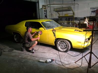

Cutting and buffing paint night before the show with the painters

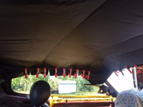

Headliner was a pain in the *** lots of little tweaking to make it look good

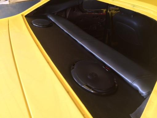

Made my own package tray using masonite board with some headliner foam covered in a black
vinyl

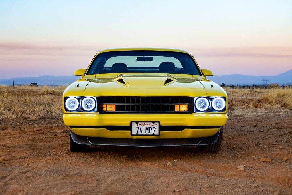

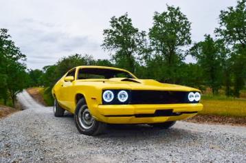

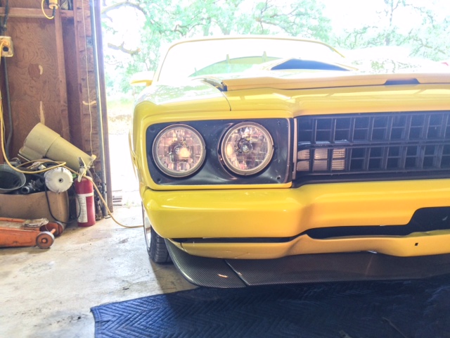

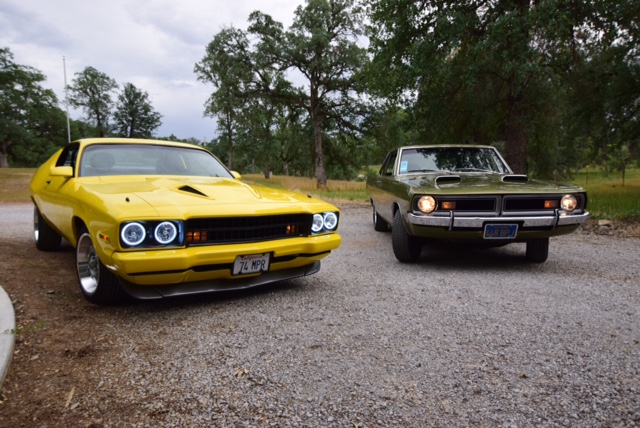

Also decided to use Oracle's halo headlights but i did take a little bit of modifying to make them fit. While i was working on the the headlights I also rewired them with a relay so that they now draw power directly from the battery. So much brighter now its incredible.

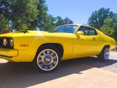

Also finally settled on wheels. Decided on the Year One 17 inch rallyes

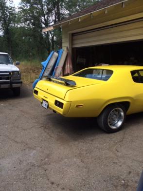

The spoiler and go wing I had hydodipped in carbon fiber turned out awesome, the guy knocked it out of the park. Also painted my headlight bezels to resemble more of a looped grill.

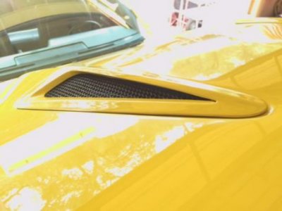

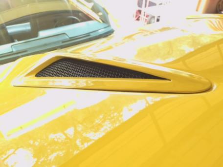

Got the functional scoops installed, found this cool mesh online.

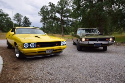

Then we headed to the show! The Dart is my dad's daily driver he has had it restored for about 3 years now, it was awesome having our cars side by side for the first time.
