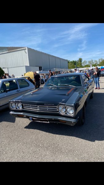

Today on a car show I discovered a very suspicious ride

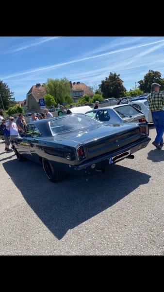

19xx body
1969 grille and taillights
1968 side markers

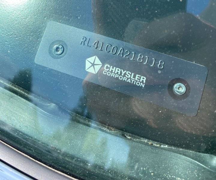

Non matching Vin tag
It can be the cleanest 4 to 2-door conversion I‘ve ever seen or the worst choice of a „replacement“ vin tag
Sadly I didn’t met the owner he was gone too fast
Still a nice ride but for us B-Body folks I think we all want to know how this car was born

You can't be serious. Or should I say, he can't be serious. THAT VIN plate was on the dash of THAT car ? :rofl:
Hmmm... I just noticed your location. I got an inkling of what went down on that car. Is the owner of that car in the market for a bridge I can sell him ?
VIN: RL41COA218118
COA stands for "Certificate Of Authenticity"
:rofl: :rofl::rofl:
It would be great to see the fender tag and/or broadcast sheet.
It's not even a factory tag...
If you were going to have a bogus tag made for your car, why do it so totally wrong: RL instead of RM for RoadRunner, 41 = 4-door, 0 = 1970 instead of 1969. I think the great philosopher, Bugs Bunny said it best, when he said, "Whadda Maroon!".
