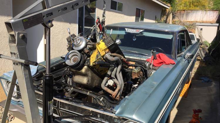

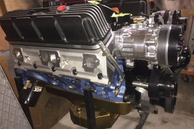

I have the new engine built, and needed to take the engine/trans out so I can ship the trans out for some high performance components to be added. It was a long day and other than a couple of hickups, the engine and trans are out and they are now separated, pending a divorce.
The trans gets a close ratio planet set from Performance Automatic and when it comes back the new union goes into the car - but not before I get the firewall smoothed out and the engine compartment blasted and painted (probably a charcoal gray). I'll make new brake lines to go with the new Baer Master Cylinder, and then rewire the car (again) with Ron Francis Wiring. Going to be a busy summer!

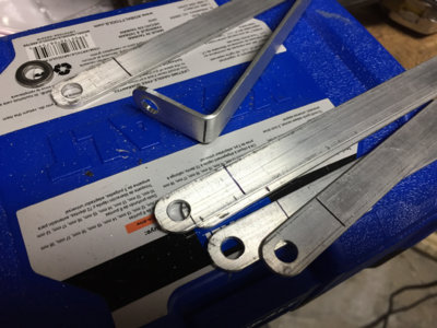

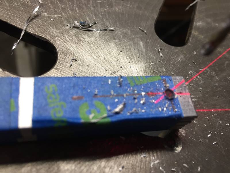

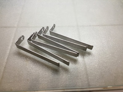

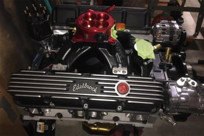

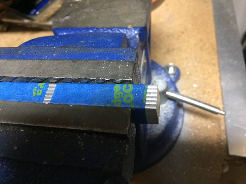

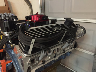

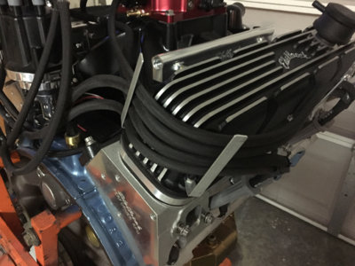

I'm slowly dressing up the 408 and decided to get creative with the Plug Wires to keep them up and out of the way of the exhaust.
I started with .5"x1/16" aluminum stock, cut to 6" in length, and mocked them up. Turned out pretty okay, Will probably look nicer when all the wires are cut and crimped, but here's what I have so far. The wires are FAST FireWires, 8.5mm plus sleeves, and I found a set of aluminum wire separators from Summit that fit up to 10mm, so they're perfect for this.
