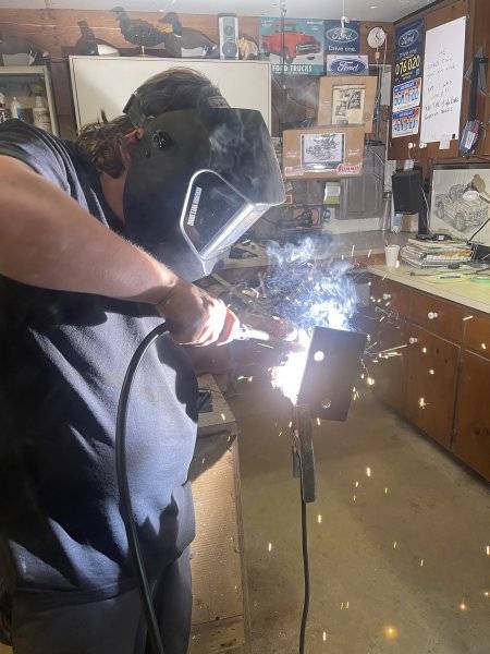

Then, we started welding up the bracing or framework.
Thank you for reading. Eric and Jason.
While Jason was welding I noticed a “picture” waiting to be taken that took me back in time.

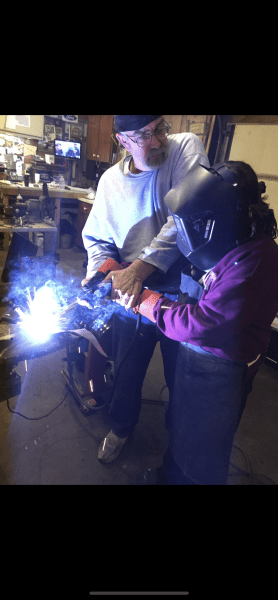

Same shop, same kid, same welder, same helmet.
Grandpa taught Jason how to weld.
It’s days like this that we miss him most. But we know……he’s always here.

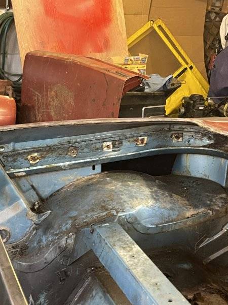

We removed the “tack strip” or whatever it’s called around the convertible top well. It holds the sail panels and contains the buttons that the cover snaps too. We only broke 3 bolts so I feel it went pretty well. Lol
There was very little rust in this area. Which is surprising considering how much rust the rest of the car has and how neglected it was for so many years. Happy surprise.
