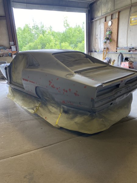

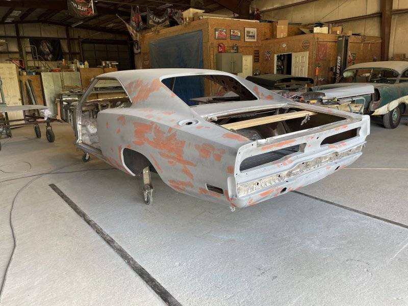

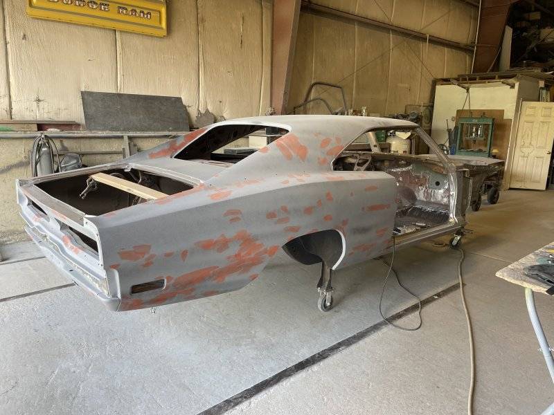

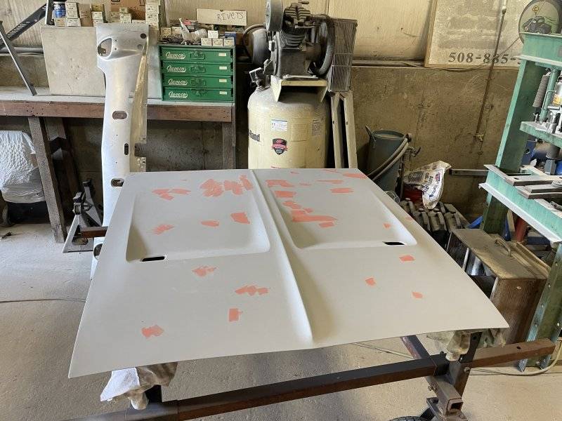

All that red lead covering small dings, why not do it before priming. My answer would be to cover bare metal to keep it rust free?View attachment 1685240

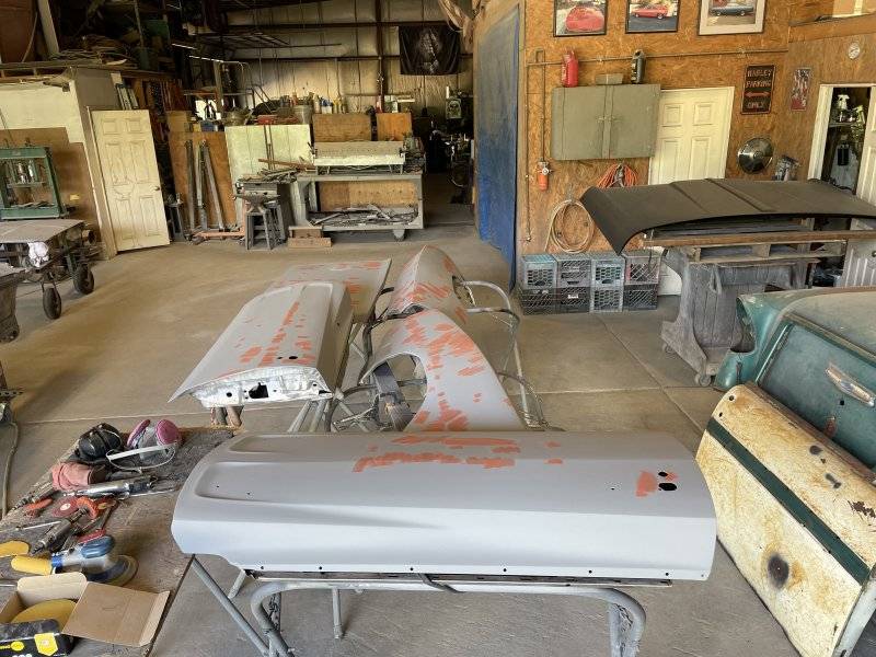

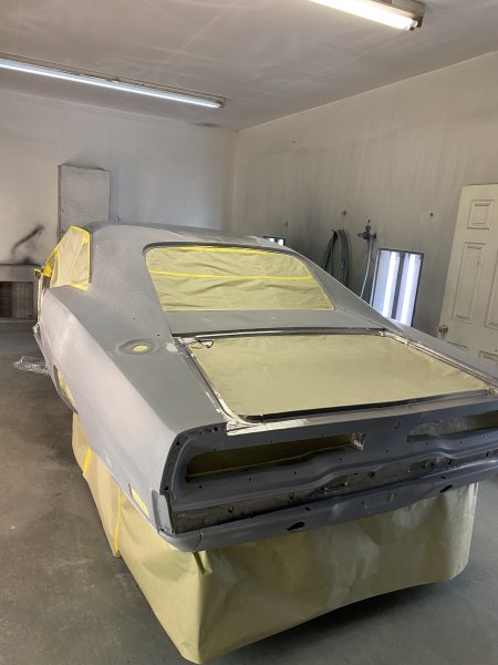

Latest pictures from today. It’s getting closer.

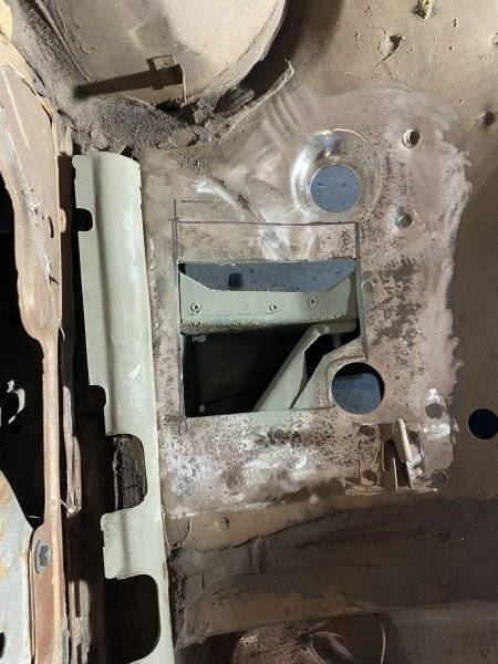

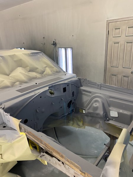

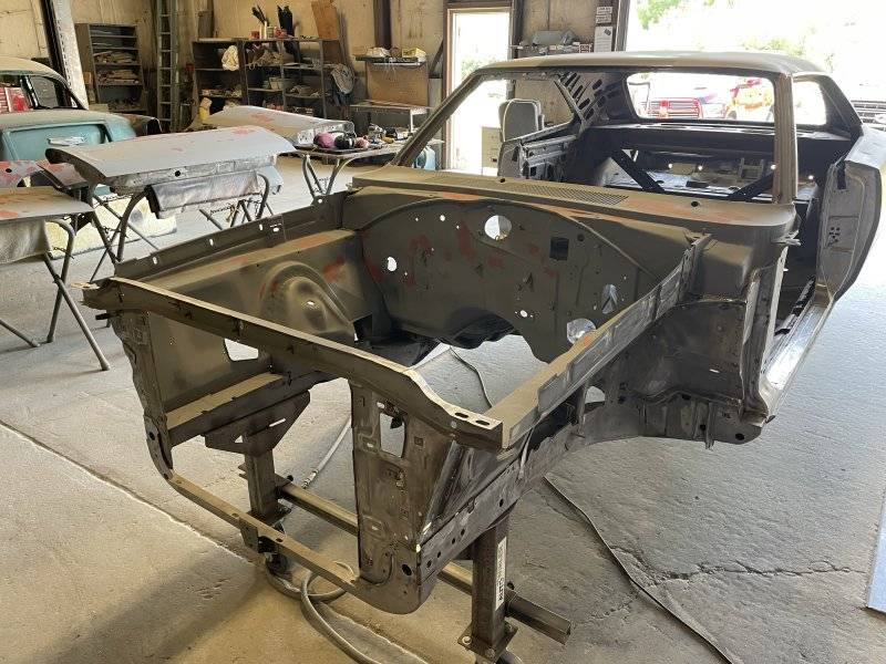

The green colored firewall patch....
I'm guessing that is a modification to accommodate the modern A/C from the 6.4 setup?
All that fed lead covering small dings, why not do it before priming. My answer would be to cover bare metal to keep it rust free?
Nitro-Stan.. That is old school product for filling fine scratches in bondo typically. Most use spray poly these days but I would guess this guy has been doing body work for decades and simply has his own ways of doing it and is sticking with it. It's amazing how many times a car get gone over to get it perfect.The red patches look like spot putty to me, a common thing when addressing small imperfections.

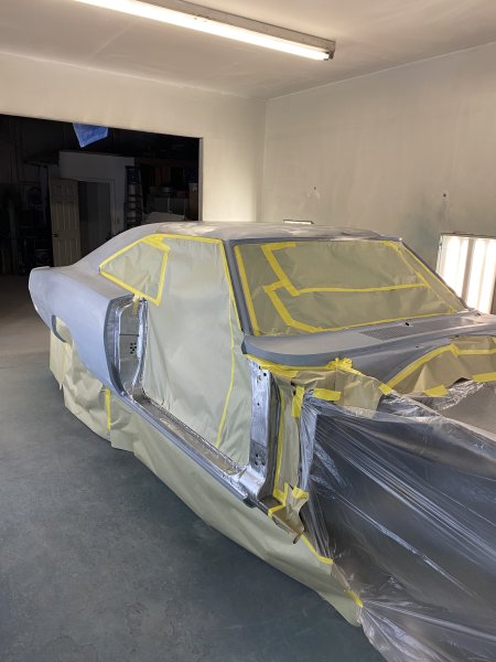

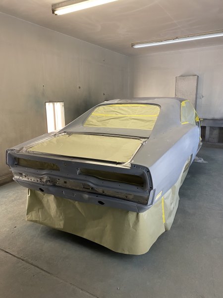

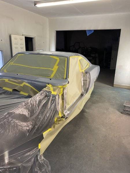

Two coats of epoxy primer on it now. 3-4 coats of gray primer going on tomorrow.
looking pretty sweet to be called the Roach.
