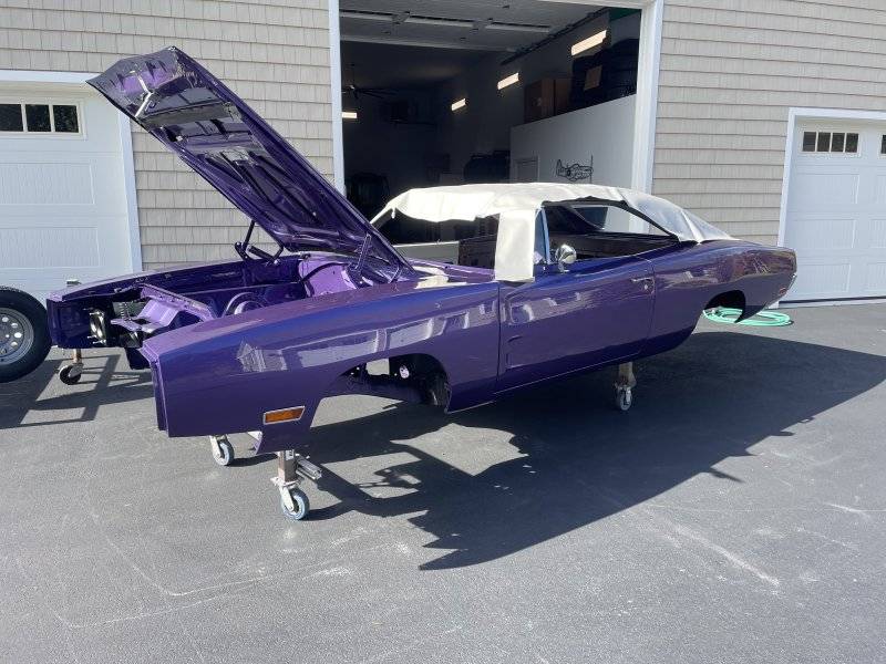

She's a "perty girl", that's going to be nice...I chose the 1968 pearl white instead of the 69-70 solid white for the vinyl top. It is still very white. Must be the lighting. The rest of the interior is standard 1970 white, which is a creamy white.

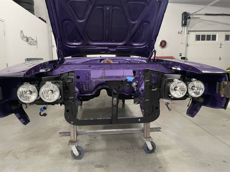

Mark,were did you buy the LEDs?Not much done today due to yard work, but I got in some time late in the day to install the headlight adjusters, buckets and LED headlights.

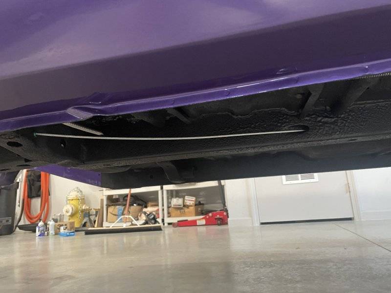

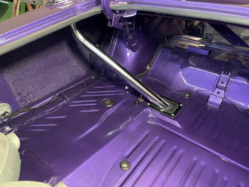

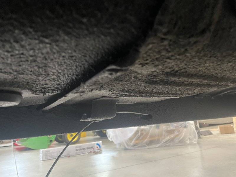

I ran tubing for my battery relocation to the trunk years ago. Very good idea!!I got this idea from someone here on the forum who ran the same frame connectors. Weld in a 1/2” piece of steel pipe at the proper angle for the e-brake cable.
I did the same thing ten years ago when I built the second Charger convertible.I got this idea from someone here on the forum who ran the same frame connectors. Weld in a 1/2” piece of steel pipe at the proper angle for the e-brake cable.
This will be my next fabrication project when I get back from deer hunting. It is interesting that USCT didn’t have the foresight to have this clearance already cut out.I got this idea from someone here on the forum who ran the same frame connectors. Weld in a 1/2” piece of steel pipe at the proper angle for the e-brake cable.

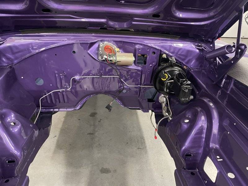

The firewall looks original. I thought you had to modify it to clear the intake.
