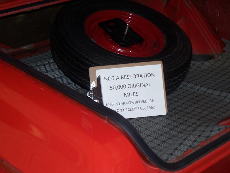

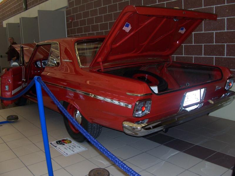

Just a thought, the rust encapsulator I use called Chassis Saver is available in a clear finish and can be brushed or sprayed on. If it were me, I'd just brush very selectively the rusty patches on the quarter and possibly try and spray some into the hole in the inside of the trunk extension (sealing the backside of the quarter). That way you can keep it just how it is and know it won't get any worse. Just an idea :shruggy:
And that's one badass 'bee! Very cool to see it in such great original condition
