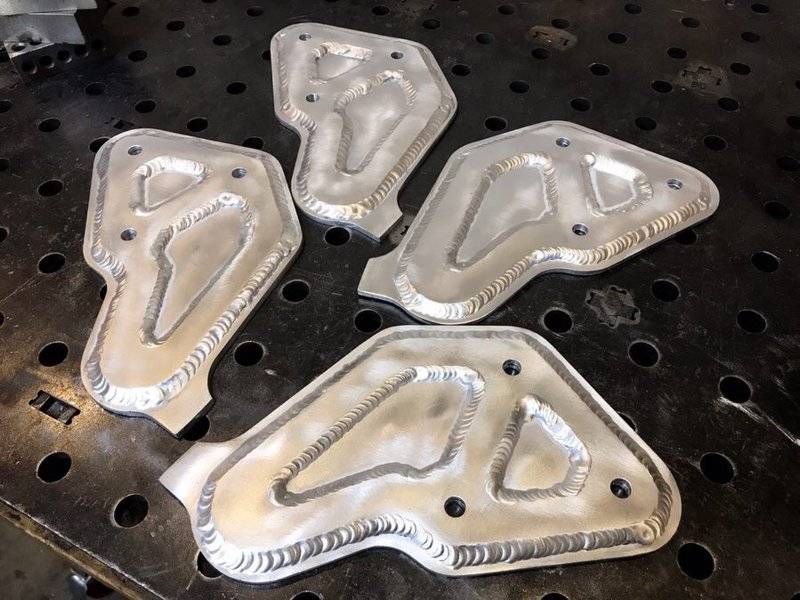

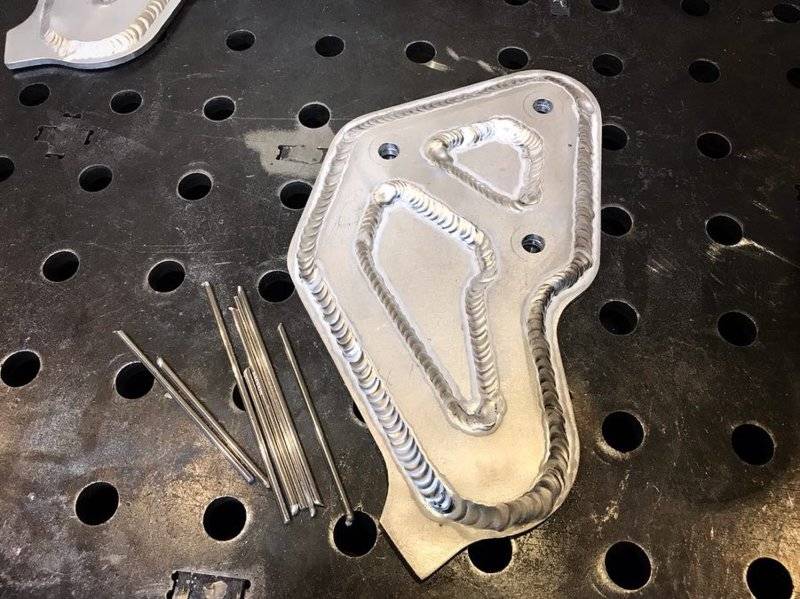

From DXF to product in 3 days. Everything is fine fit and tacked and in the chassis.
Lots of weld inches to go.
Amazing fabrication work!
Thanks! Lots of help and coaching from my mentors.

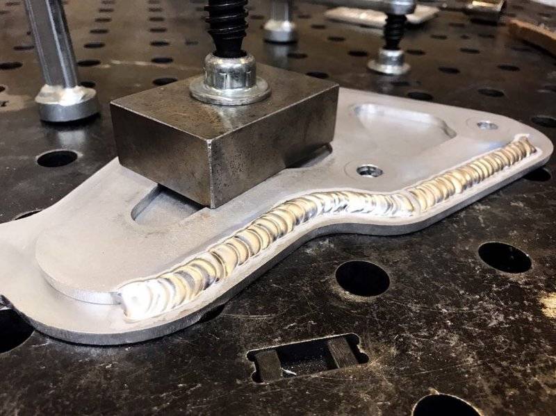

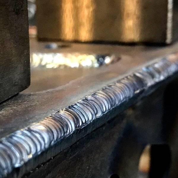

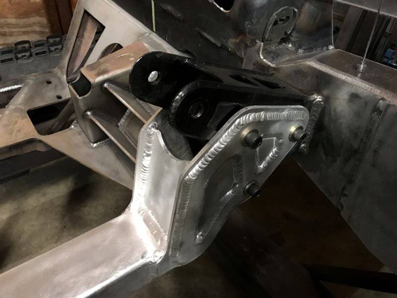

Lots of welding planned for this weekend.
120A, 100Hz, 60% on, 20% background.
David
See, now your just showing off, lol!! Very nice stacking.

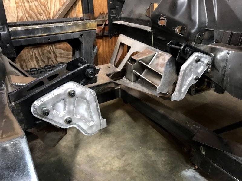

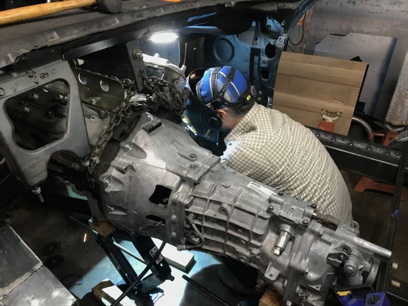

Finished the engine mounts, and picked up a new bottle of argon so I could start the engine cradle tonight.
Everything is cooling, and I’ll try to tack it all together tomorrow night.

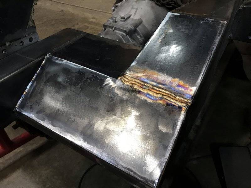

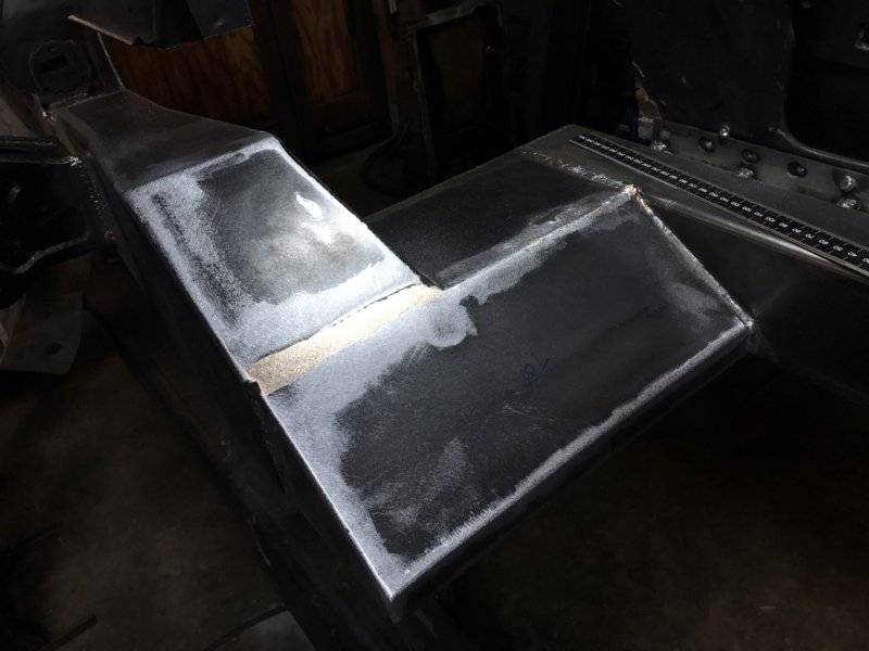

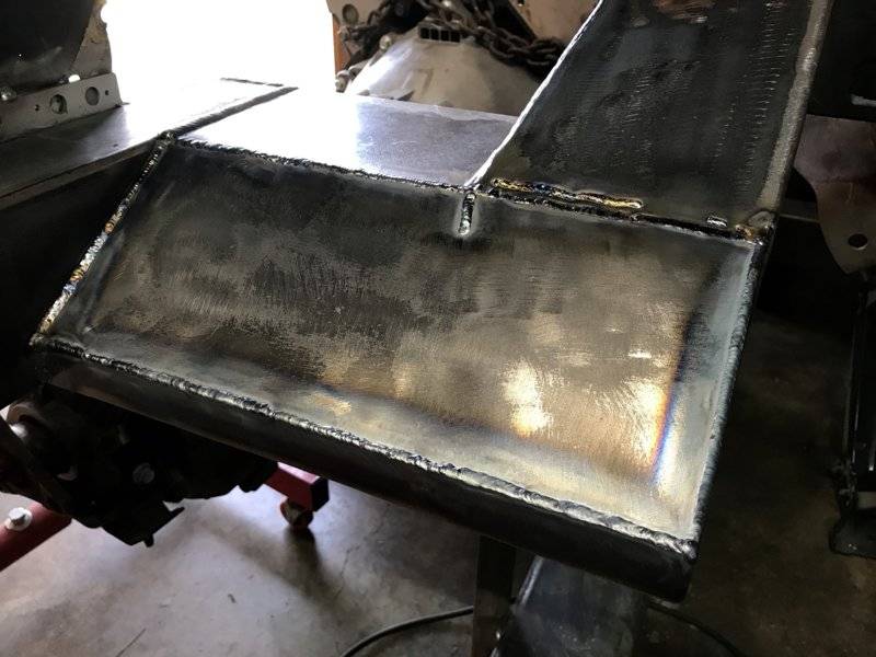

The footwells are welded and blended. After using regular 70S-2, I followed up with silicon bronze to smooth transitions. I love working with that stuff.
It grinds easily, and doesn’t overwork the base material since it isn’t technically welding.
Fully blended, with a 40 grit DA finish. This all gets covered by a floor panel, so nobody will see it, but I like to practice and enjoy these details.

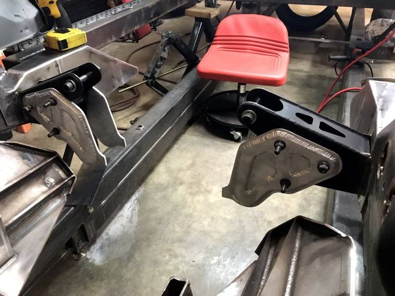

As well, my design for the engine cradle needed to be revised. Rev1 underway - I will ditch a design that is not working before I make do.
Now, to build the structure between the two.
You’ll also notice that the engine frame mounts are burned in. Final setback is 14”. Packaging my planned headers will be tight, even with this engine’s compact dimensions.

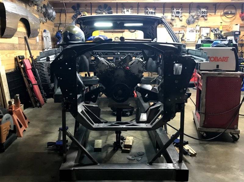

Here's the Rev1 engine cradle:
It’s ready for the powertrain, but I’m still sorting out the last details to convert my TR6060 to a Magnum.
Meanwhile, I started on the inner chassis members. More to come on these.

Art in motion!! Are you doing boost on your Lq4 6.0 or just keeping it N/A? one of the best blocks to start with.
