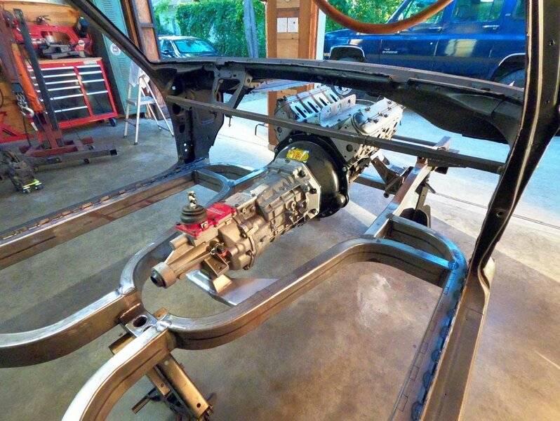

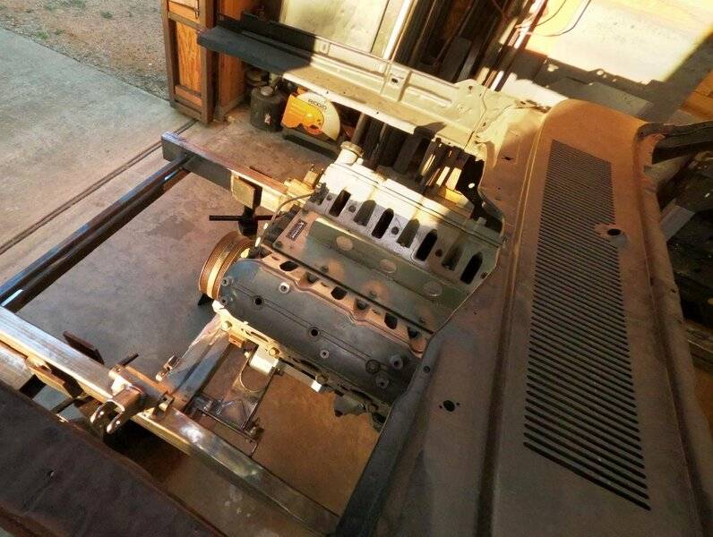

Here’s a bit of an update.

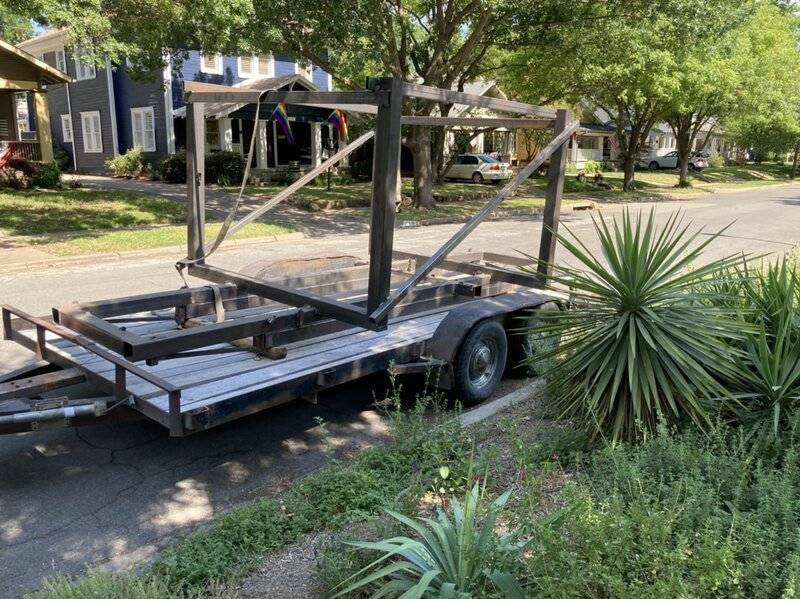

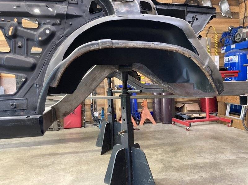

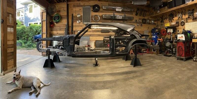

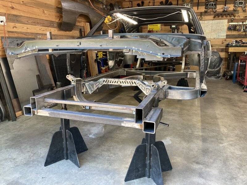

The jig is removed and sold to a local Mopar dude who’s rebuilding a Charger and Coronet. It actually slipped apart pretty easily, and moved around without too much trouble.

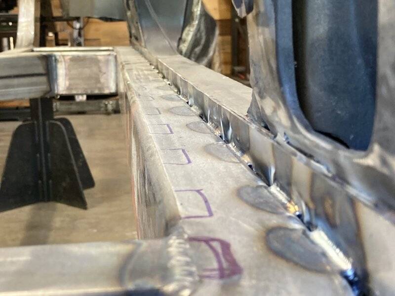

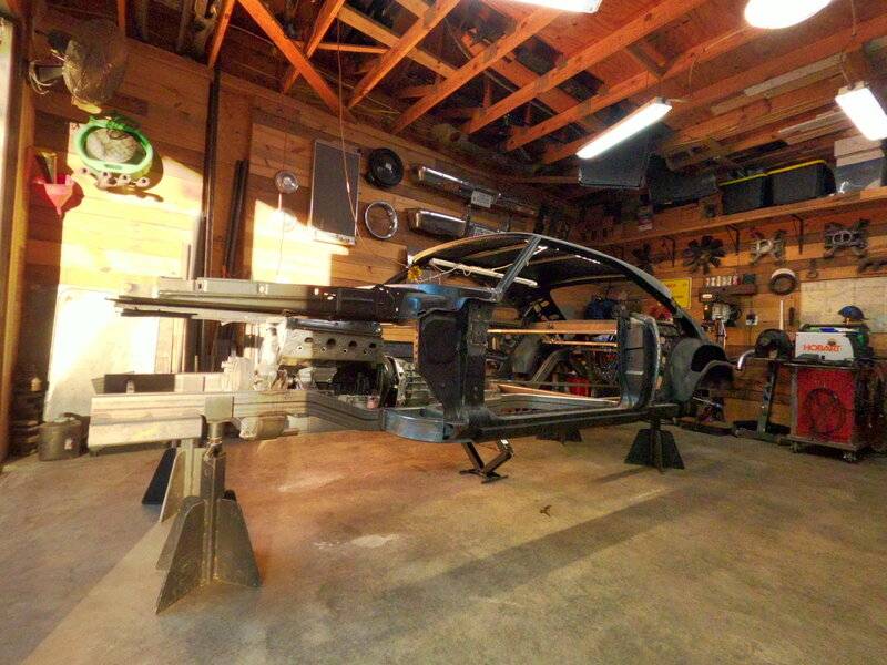

Then the car leveled up pretty nicely. The frame is pretty darned rigid. I can level up on front corner, and it lifts the same side at the rear. The cage and rest of the unibody will go even further.
The rockers are welded in 1.5” every 2”.
The front suspension is pushed forward 1.5” and the crank is behind that by just a little bit. That’s not as much as Rev1, which is good. Now, only plugs 7 and 8 are under the cowl.
This places the shifter right at my knee, which is what I prefer, and allows for a straight and vertical (and maybe gated) shift level.
I scrapped Rev1 this time last year. Now, with Rev2 fully installed and the powertrain resting in its own mounts, I’m not just caught up, but well past where I was.
I know not everyone gets excited about an old shell sitting on a new frame, but it’s a valuable milestone to me.

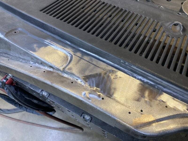

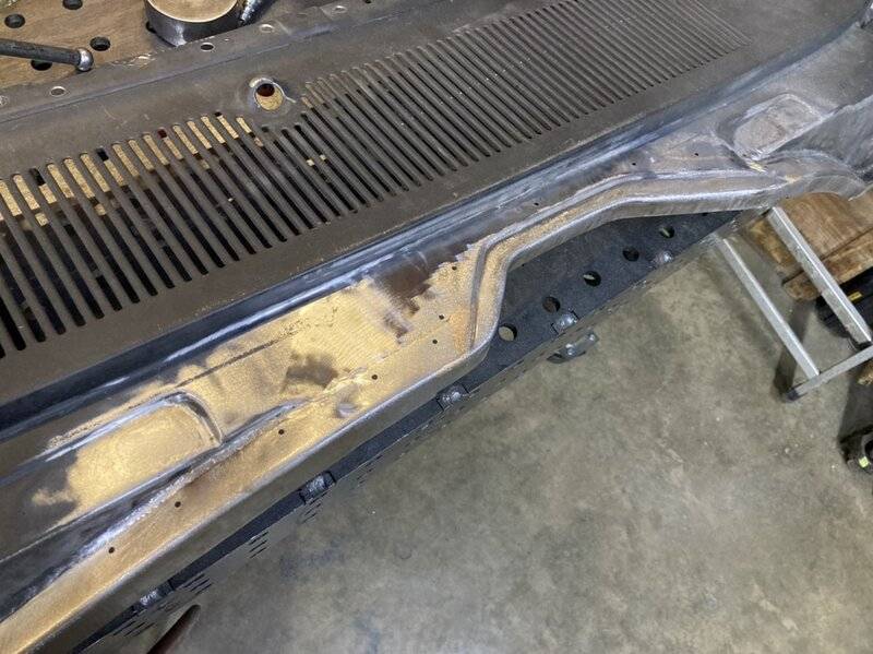

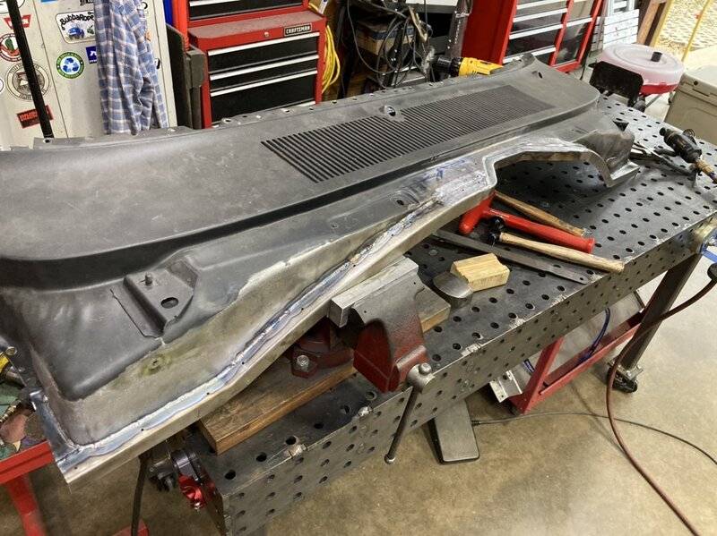

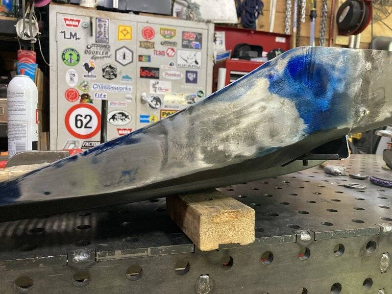

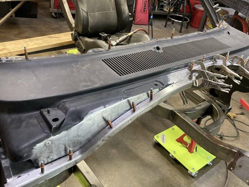

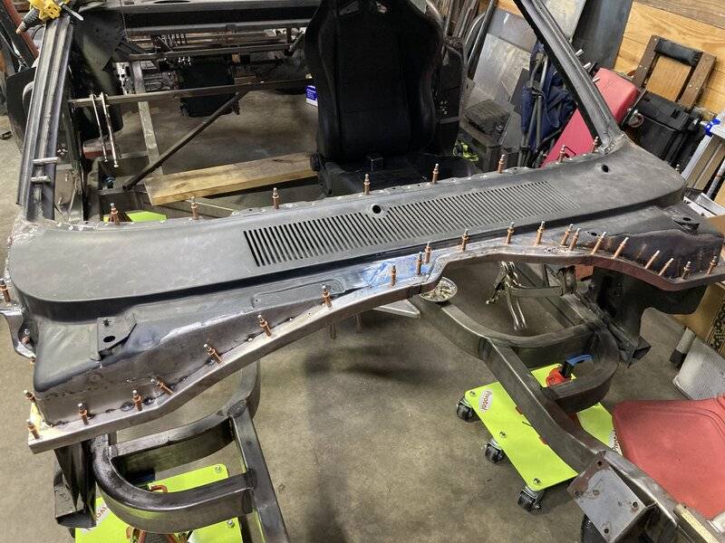

Now, I'm back on the car, and have been making steady progress for a few weeks now. So far it's all bumping metal to get the cowl closer to how I'd like it. Here's a fast catchup.
Fresh air vents closed, and new lower flange constructed.
Shrink shrank shrunk the upper flange to match.

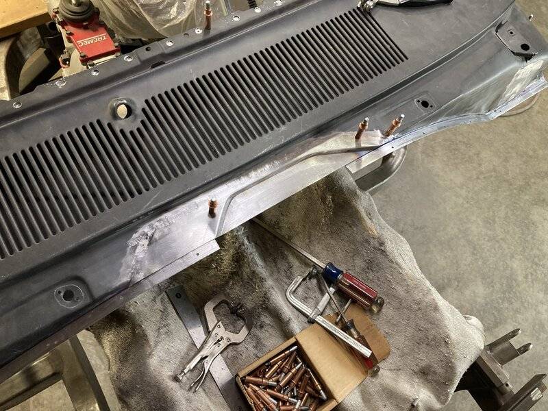

The start of the new upper cowl relief where the wiper motor used to sit. I'm trying to maintain this little cutout for access to the rear of the intake manifold, and it gives me a chance to play with a bead roller.

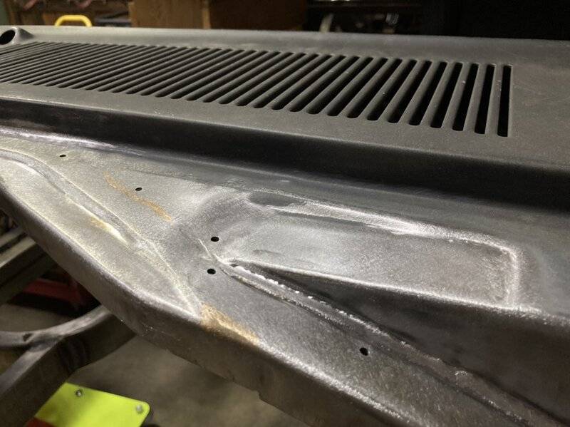

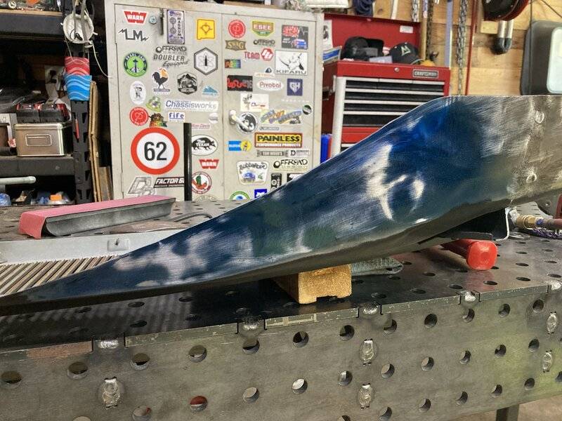

Next, the wrinkled cowls have always bothered me. I get why it's there - just part of a production car that's made of stamped panels - but since it's apart, a few hours with some body hammers is all it takes to reduce the amount of filler required to smooth it out.
It's not going to be a "no filler car," but I'm going for a low filler one.

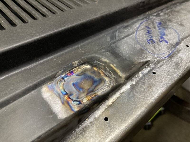

All tacked together. Likely a lot of silicone bronze TIG work ahead to get it all fit and sculpted as I have in my imagination.

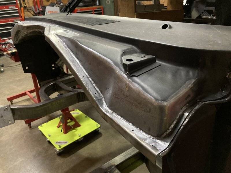

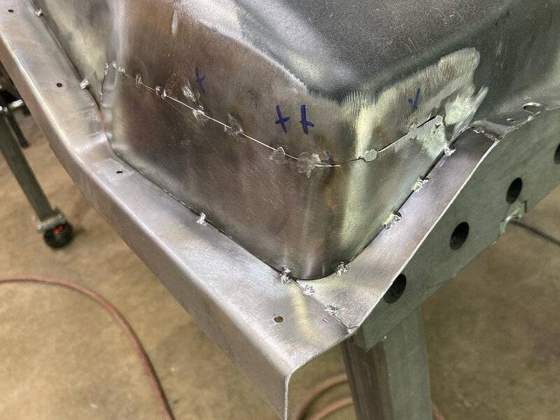

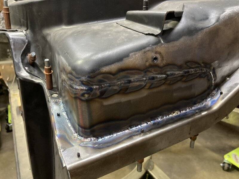

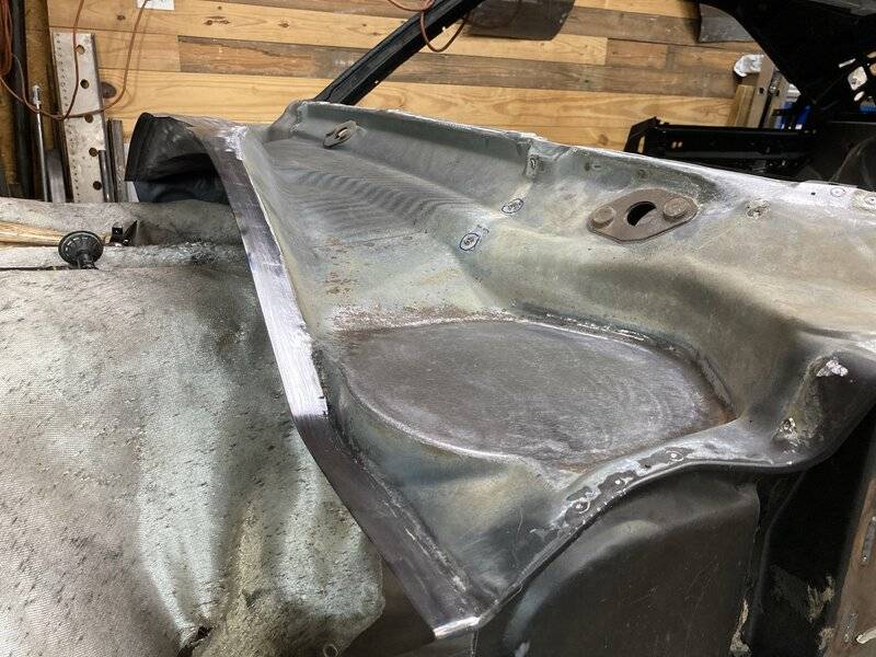

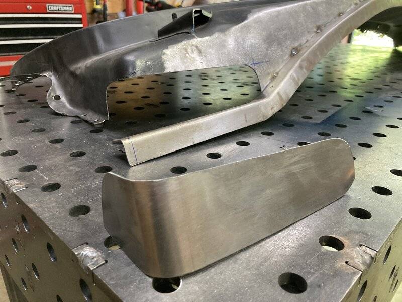

Corner filler panels. I’ve never liked the original drain design, and will make a new one that ties into the lower cowl.

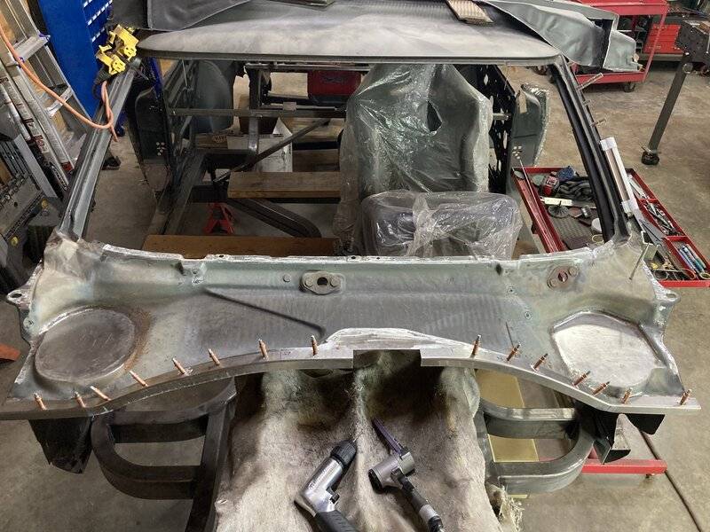

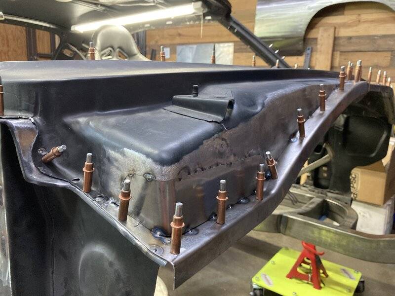

Just making steady progress assembling and blending the cowl, and filling in now-useless holes.
I forgot what these holes were for, but they’re no more.
This cowl might end job being the most modified panel on the car. Lots of small tweaks.
David
David

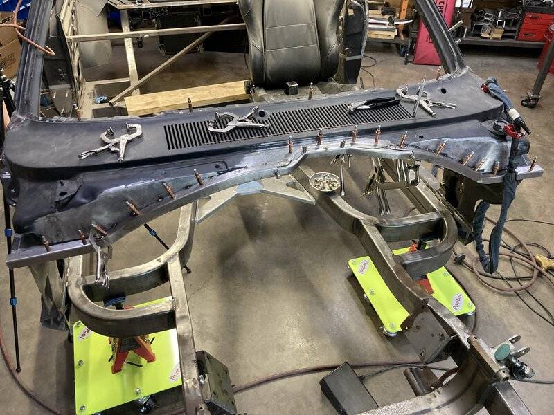

Front of the cowl is done. Next up are pillar corners, vent delete, and I’ll probably redo the side flanges.
