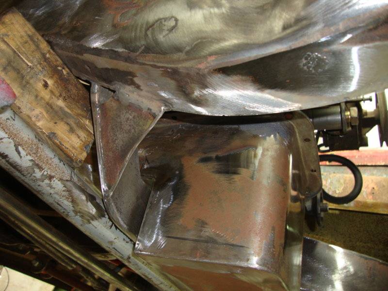

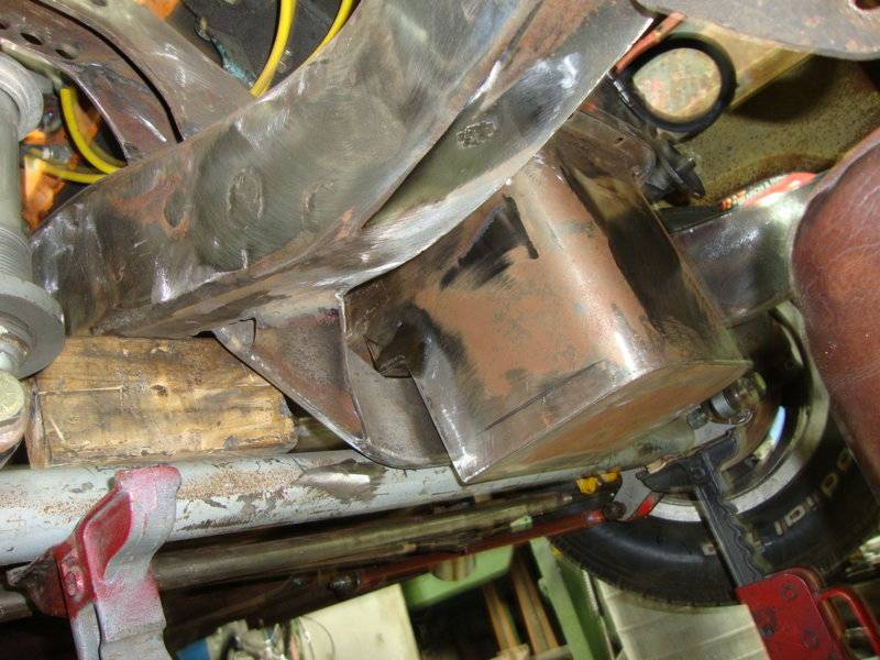

this is a remake from a center sump oem pan , changed n welded the **** out of it ! i'm not a great welder , but they never leak have i'm done . this was mig tact then just gas welded so i can deal with pin holes .

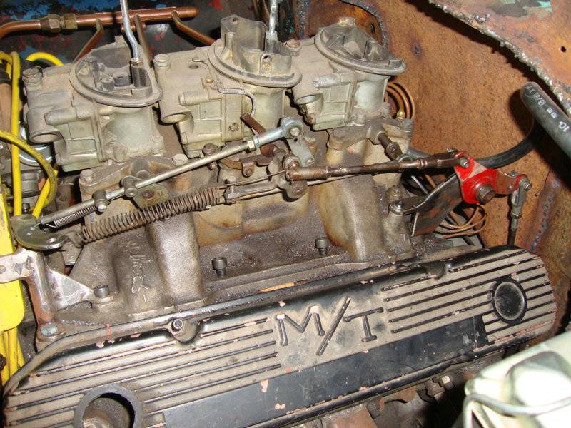

man you should at least tighten down that intake. it looks like that vehicle was pulled up with the rest of the artifacts from the Titanic LOL!

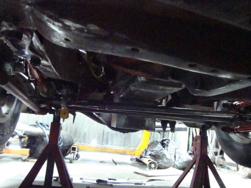

I run 8 quart pans on all my hipo motors. .i do have to watch certain dips in the roads since my pan will scuff the ground if the suspension moves enough but worth the extra oil capacity
I run the big super stock hole for the steering link pan in my 64 plymouth street car. No, its not jacked up in the air. I do have big aluminum blocks on the lower control arms that the bump stops mount on. My experience with deep pans is a well made steel pan can take quite a pounding. They will bend alot before they leak. Only time one gushed oil was when the asphalt caught the drain plug and popped the whole thing open. That was a home made pan and a learning experience.
