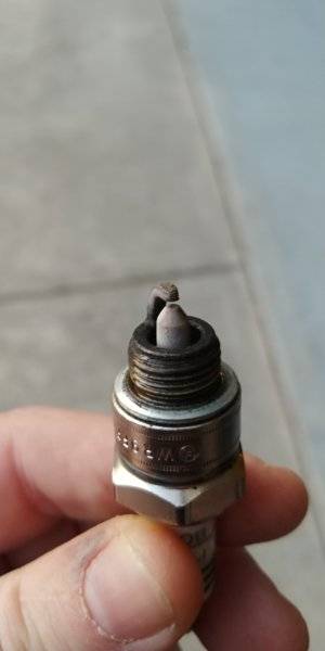

I had a bog going from part throttle to WOT which I was able to tune out with the idle mix and timing. Now I'm trying to dial out this WOT issue. It's always been there. The spark plugs look good. Maybe I don't have enough timing? I have no clue what spark knock sounds like so I can't tell you. Maybe I should I get a o2 sensor? I have a A/F gauge in the spare parts crate; I just need weld in a bung and wire it up. Maybe the stock 45 gph fuel pump can't supply the carb with enough fuel? I read that adjusting the floats help. I don't really don't know much about this old school stuff as it is still very new to me. But I want to learn everything I can about it.

If it was running rich, your plugs would be much darker in color. Looking at your plug, it appears to me to be on the lean or hot side. I was looking at your plugs and maybe that range is too hot for your engine configuration, but I don't know what year the motor is that you have there. For reference, using 72 383 specs, your plug crosses over to champion 18 series, where stock plugs are 14 or 16 series and some lower performance engines use plugs are 11/12 series, and with the cam you are running, you might want to try one range lower and see if that helps because running too hot of a plug can cause lean conditions.

Ap85 crossover to the same heat range as what you already have installed.
