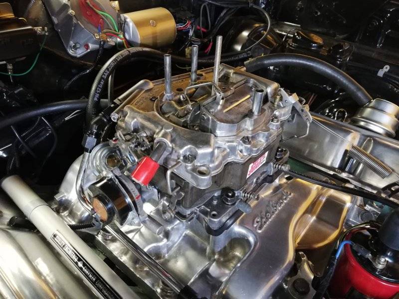

Also from your picture above the S link for the accelerator pump is on backwards. It should look like an S when looking at it from the front. It will affect your pump shot if backwards.
I stole that shot from the internet. I was studying the photo and it dawned on me, forehead slap, it isn't mine. whew.. but that's something to know.
Still have one TQ hanging around for some reason and the S link is on correctly but have had them on backwards before and didn't have any issues with the AP. Did notice that the link has a slight bend in it and can see where it may make a difference if backwards. Been a long time since working on a TQ and yet still learning about them lol. I do know how nice they are when they are tuned right!
