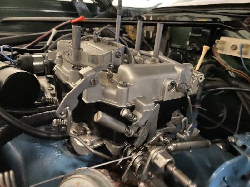

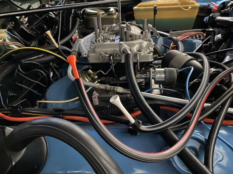

Nice pics. Now show us a nice pic of the Carburetor.
