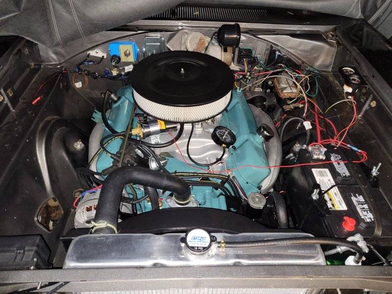

Looking for some advice on tuning my new rebuild. Let me start by saying that this is my first engine build so I don't have a lot of experience to lean on. I've been reading and watching plenty of video's on carb and timing set up, but still a bit unclear on which to adjust and in what order. This is where I am at:
440 .030 over
Stealth Heads
Weiand Action Plus Intake
Edelbrock AVS2 800 cfm
HP Manifolds
Comp CL21-222-4 Cam & Lifters
10.3 to 1 Static CR
Summit Electronic Ignition Conversion
Cam Break in was a little rough, I stabbed the distributer at ~12 degree advanced and it fired almost instantly on the first go, I didn't let it idle at all, went straight to 2000 RPM for the break in. I did have to shut it off twice during break in, once because it sucked the 5 gallon gas can dry at the 18 minute mark. Then after cooling and retorquing the head bolts I restarted it and had a massive valve cover oil leak (split the cork gasket), shut it back off and had to wait a week for parts and time to run it again, primed the oil pump again and ran another 10 minutes (and another 3 gallons of gas). It has between 25 and 30 minutes total of run time above 2000 RPM. When I tried to lower the idle speed screw ( I was using that to keep the RPMs up) it really didn't want to go below 1000 RPM, it ended up running really rough and wanting to stall at around 1000 RPM, I feathered the throttle a bit and got to stay running smooth around 1200-1500 RPM but that seems too fast for a curb idle on a warm engine.
Where should I begin with tuning this? Many of the videos I've watched talk about 30-35 degrees total timing is that with the vacuum advance still unplugged? and at what RPM would I check timing for total?
I've made no adjustments to the carb, I ran it right out of the box. Idle mixture screws are 1.5 turns out and at 2000 RPM it sits right about 20" vacuum.
Also fuel consumption seems excessive to me but then again this is my first big block...but ~7-8 gallons in less than 30 minutes?? It's not leaking anywhere that I can tell.
Any advice, suggestions, or anecdotes appreciated!
Ignore the mess of wiring, most of it is temporary.
Well I'd start by getting it running, around 900rpm, or 1000 if that's as low as it will go, and get a timing light on it. Will likely enjoy more than 12 degrees of timing with that setup.
Not knowing what advance curve you have, I'd shoot for around 16 degrees of initial to start, 34-36 all in on the mechanical with that compression (others may chime in). Yes, you set this with the vac advance unhooked.
I'd be checking for any vacuum leaks as well, as that can cause rough running too.
I see you have a vacuum gauge, so you'll wanna find your highest vacuum with the mixture screws.
You may also want to pull the air horn & make sure that AVS2 has the floats set properly, since they likely aren't (ask me how I know).
Good luck.

Check the float level [ 7/16"] in the carb & also check that needles & seats are sealing. Unlike brand H stuff, you will not need gaskets if you are careful removing the top.
I really don't see how 5 gals of fuel could be used in 18 min. There would be black clouds everywhere & hard to breath....maybe there was less than 5 gals in the container?
12* initial timing is ok, but not ideal, but engine should run ok & idle ok.

take a look at your oil and check for a strong gasoline smell. no way should it burn 5 gallons in 18 minutes at 2000 rpm. you could easily damage the bearings with a lot of gasoline in the oil. a new engine will have considerable blow-bye until the rings get seated which is bad for the oil anyway. could you have excessive fuel pressure? try about 17-18 degrees of initial timing with no more than 36-38 total. your lifter preload is fine at .050. probably wont idle well below 900,especially before rings are well seated. good luck.

Mechanical all in @ 3000RPM on a fairly stock build, some like it in by 2500.
And yes, all of those things. My AVS2 floats, out of the box, were not even close to what they should be.
