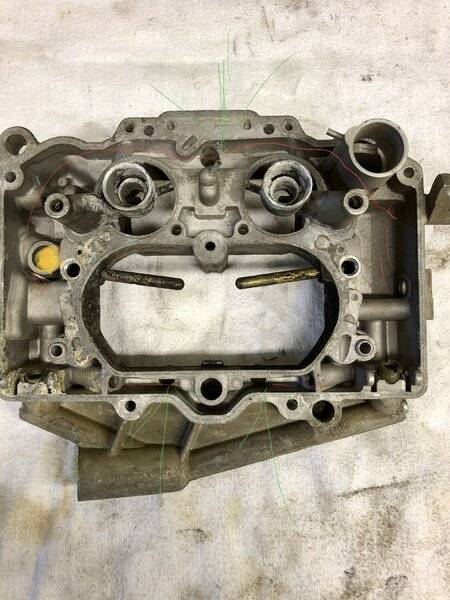

This is a 2124 air horn the top part of all production 6322 Thermoquds. The yellow dot is where the external bowl vent exits. The green arrows are the 3 bowl vents that exit into the air cleaner. The red lines are their path of travel. If the your theory of the 6322 external bowl vent were right, then every single aftermarket Holley would have hot start issues, especially since they are of all metal construction. If you apply your theory to the electronic bowl vent TQ’s them you’ve got something. The OP has a 67 GTX and I presume no charcoal canister, so then he cannot connect the purge port in the baseplate to even make it a closed loop, as was intended. So that don’t hold water either. I don’t appreciate you insulting me and my lively hood. Guys like you are the reason I am reluctant to help out on these forums.
Not my intention to insult anyone, merely expressing an observation. Your picture shows the idle bowl vent valve removed, does it not? My theory? No, idle bowl vent valves are quite common on OE carbs from this time period, both open and later enclosed, including all the OE Holleys. This discussion is not about aftermarket carbs, as stated, few aftermarket carbs today include them. Many replacement aftermarket carbs from the day had them, however.
Purge port? Closed loop? On a vehicle not running a evaporative recovery system using a charcoal canister, the purge port would not be used, nothing to be purged, the purge port would need to be capped off. The purge port has nothing to do with the primary function of the idle fuel bowl vent valve.

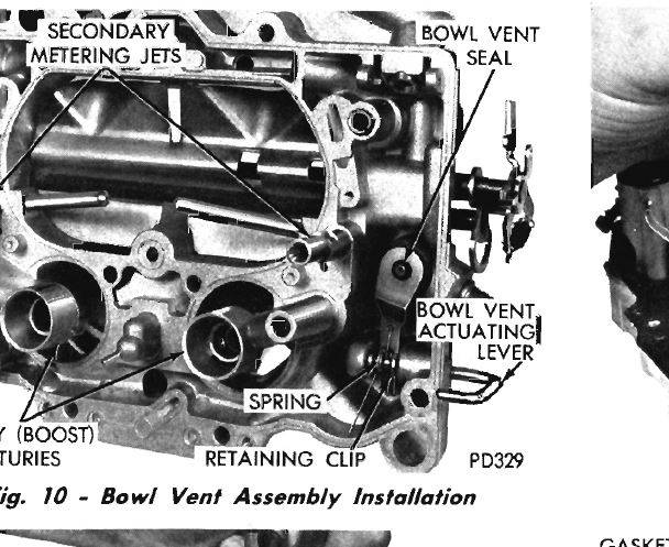

It only has the one external bowl vent and the internal vents that vent the bowl to the air horn. Depending on the year as to how the external bowl vent works as some are just mechanical and have the arm that open the external vent at idle and closes it off idle. Others use a solenoid and vacuum to open or close the external bowl vent as on that one it uses vacuum to close the external bowl vent when started and then has the electric solenoid to keep the vent closed when running so if you step on the gas and the vacuum drops the solenoid still holds it closed when running. When its running and the external bowl vent is closed it then opens the bowl to the internal bowl vents so its a balanced carb and vents the bowls to the airhorn which can change from normal atmospheric pressure when running with the air going down into the eng by the internal bowl vents. It only has one nipple that is for the external bowl vents that vent the bowls to external atmospheric pressure. Some will have about 3 vents that vent internally to the air horn and none of them are the external bowl vent. Like I said the external bowl vent was worked a few different ways over the years that carb was used due to the emissions laws. Ron
