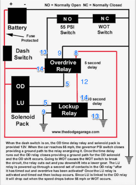

First comment, has he torn it apart to confirm the eight bolt crank? Chrysler changed the 318 poly to a six bolt crank in 63.. 62 & earlier is eight bolt 63 & newer should be normal...
Second you can control O/D & L/U automatically with a few simple components, if your interested I can provide links for the parts... Pretty cheap & easy...
Yes, he removed the inspection cover and used a flashlight and mirror to verify 8 bolts on the flywheel. This is a 66 Poly 318 original to the truck as I understood it, so not sure what is up here. I am aware of the automatic OD, but is a 46 RE required for the automatic OD, or are you speaking of making the mod to a 46 RH?

46 RE requires electronics to control every shift and to control pressure based on a few inputs... Much more elaborate than the circuit I posted above...
What I posted is for the 46 RH... It uses a pressure sensor in the governor test port to determine vehicle speed which is the first input to control the shift into O/D
Then the timer built into the first relay whats to see the speed stay above the preset speed for a preset amount of time before it shifts into O/D.. The reason for the time is to prevent O/D kicking in & out repeatedly....
After the O/D timer is satisfied power is fed to O/D & to the L/U relay where a second timer needs to be satisfied before it sends power to the L/U...

Is it possible to set it you to where the driver can control both the OD and the LU? There have been lots of times where I'd like to shut off the LU and not downshift out of OD. There's a bridge near me where my V6 Dakota will go over it without much of a problem as long as the LU doesn't engage....and that takes some light brake pedal pressure.
Pretty simple to do it that way..
The rear wire to the three wire plug is L/U, simply add a switch to that wire...
