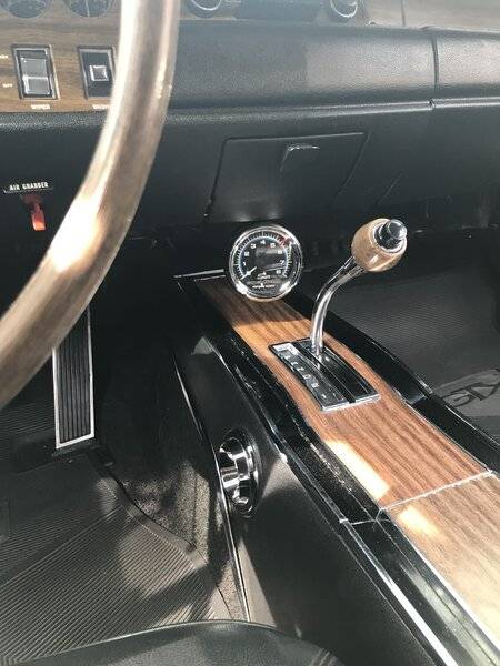

Mine is.on the console in the factory location. It's wired to be illuminated the whole time.

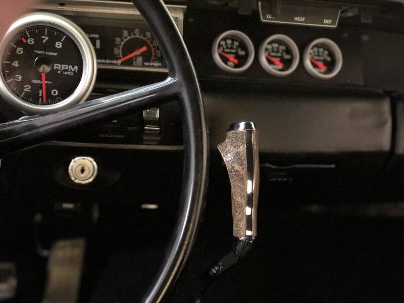

I can't help on the wiring sorry - I got an auto electrician to hook them up for me. I'm more mechanical repairs than electrical. The gauges left to right are: Water Temp, Oil Pressure, Volts.

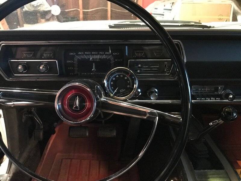

Back in the day, we installed Sun Super Tach... that was by far the popular setup. Either on a strap around the steering column, or above/below the dash. The original ones had a separate control box, I still have a complete original setup. But, the new ones manufactured eliminate the separate box. That's what I got on MY steering column, in front of the useless clock. Period correct for "day two" cars !

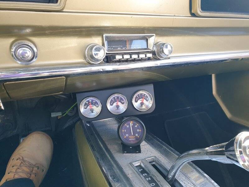

very nice! I love seeing the tach pics..... I am liking the tach on the console like UnderPressure, but also thinks it looks cool on the steering column.
I like on steering column also, but then found a hole under the ashtray and still used the steering column mount upside down, kinda liked better, I like the older Mopars on the console
