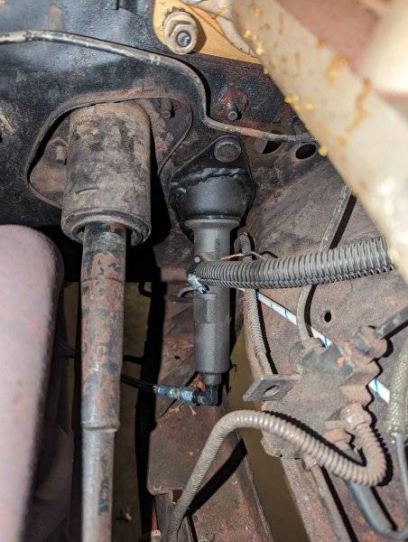

I thought about a hydraulic clutch and I even bought all the stuff I need to make it happen. I was going to use the Wilwood pull type slave and a Howe master. I seen pics of a mounting bracket for the pull type bolted to the side cover of the transmission.
Gus
I used a pull type Neal slave in my last dirt modified...made a bracket that welded to the frame.
I also had one that bolted to the side of the trans tunnel.

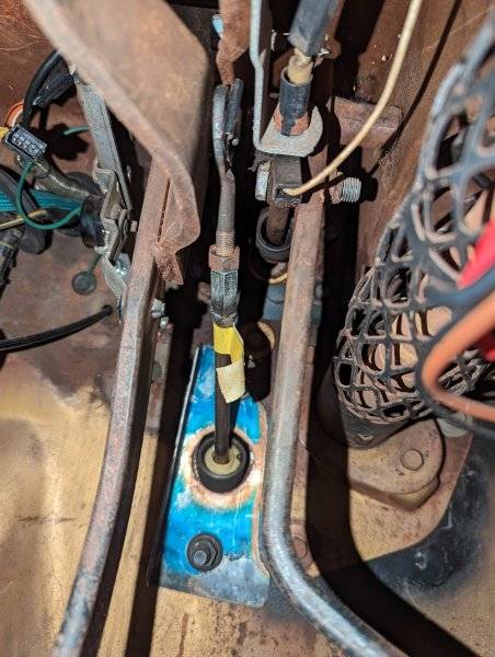

That's looks nice. Is that angled bracket from the dakota too?
Yes, the 45 degrees from the firewall is good but it also had about 15 degrees to the side that I straightened and now it's good in both directions.
