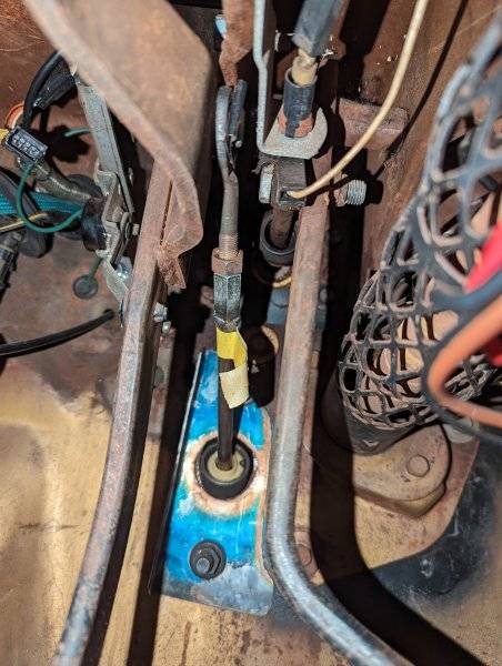

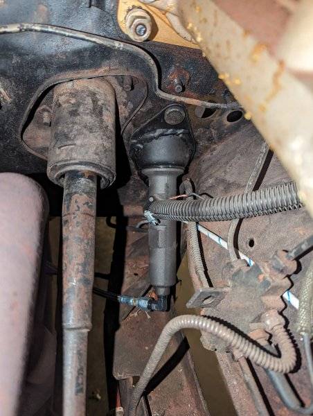

I used a master cylinder from an early '90s Dakota. I had to modify the firewall bracket and the push pin but it works quite nicely.
I got it from a pull apart.
