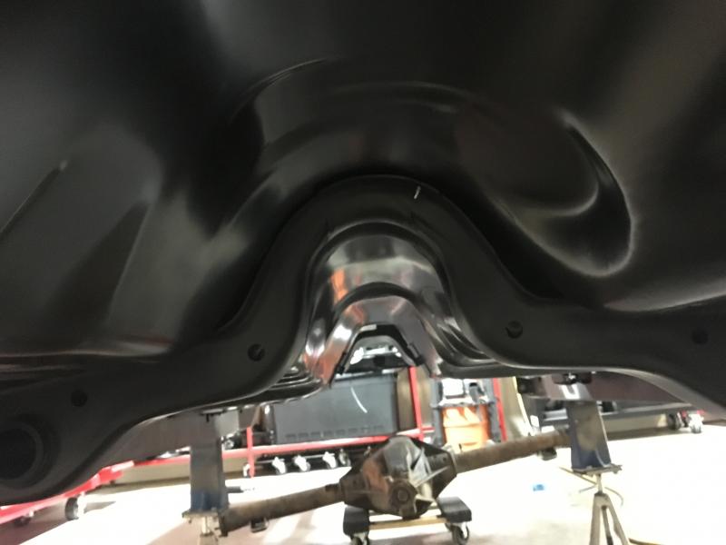

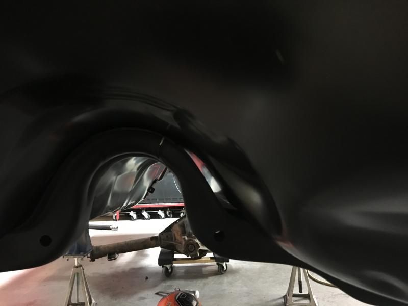

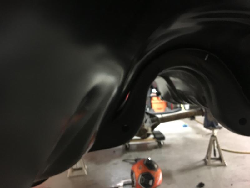

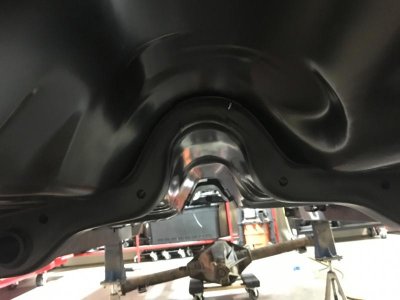

I bought a Goodmark pan many months ago off of ebay, and I'm just now getting to the nitty gritty of test fitting it for final weld and the center hump is pretty far off. I sheet metal screwed it at the top on the side that needs to be sucked in and it just bent the metal. It doesnt budge when I push it towards the passenger side and Im afraid even if I do push it in it will just bulge at the very top of the hump.....
The piece also doesnt have the correct profile to fit the inner rockers correctly (fixable), the drain holes in the center pan pieces dont line up correctly, about 1/2'' off(fixable), and a couple other frustrations that are fixable, up until this latest fitment issue I've been hopeful, but I think its time to throw in the towel on it.
So, I think I might just take it as a loss and try for the AMD piece and hope for better results. Unless you guys have some better ideas.
Thats the pitts, I'm putting an AMD floor in my 69 Runner, fit like a glove when i laid it in last week, fit snug and on the frame and supports as its suppose to.
