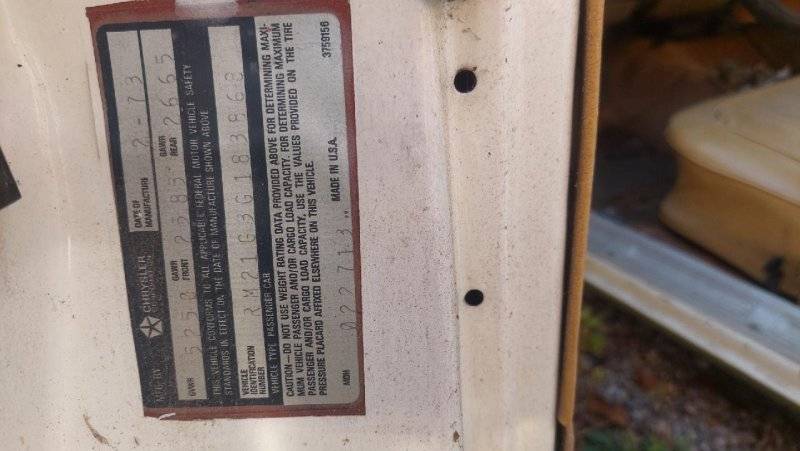

OP didn't say what the dash VIN says.
Interesting that the door sticker says RM, even though the door looks like it belongs to the car, IE not repainted to match.
That suggests the car may be a RR but without a correct title.

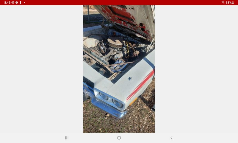

To me, that cluster did look loose in the dash from the pic, not to mention the odd speedo swap.

The firewall is white from the factory. The underside of the hood eas not. They did a poor tape job on the driver door vin. Obviously not white from the factory. Hopefully the dash vin matches the title. I'll find out later today.

It looks like a great car...not much in terms of aftermarket parts are available. Finding one in good shape is important! This appears to be that! The sales brochure even appears to be the same color of interior. It was optional in either a satellite or a RR. It appears to me the car might be a satellite and got hood and door installed of a roadrunner...judging by the paint. It wouldn't matter much to me..it's still a great car. If you want to dig deeper compare vins with the radiator support. Hopefully the dash vin and title matches. The door vin is just a decal.

Okay. Silly question. The door vin tag on my car is RM21G3G and the title is Rh23G3R. Shouldn't both have the same third and fourth digit on the vin? Unless of course the RM door came from a car with fixed rear glass. Would that be correct?

Certified speedometer brings a swap into question for sure....and the RH & RM mix-up is probably common when folk couldn't get what they wanted, so they jazzed up what they had.

Okay, R= Satellite/Sebring
M= Medium price class, that being a RR. ("H" is high price class that being a Sport Satellite IIRC)
21= 2 door sedan coupe (23=2 door hard top)
G= 318 2 bar. carb.
3= 1973
G= St. Louis, MO ("R"=Widsor , ONT, Canda)
Last six are the production numbers
So are you saying that both these VINs have the same production numbers (that should never happen).
If the door VIN is completely different then the door probably came off a donor. No big deal as long as the dash VIN matches the title. For someone in the past to have swapped out the dash (with VIN attached) would be rare, possible but not probable.
If you are still worried just check the partial numbers on the radiator support (that should match the dash numbers).

The door vin is just a decal, I believe you can have reproductions made. Doors get swapped all the time...not a big deal.
The 318 roadrunner had factory dual exhaust the satellite Sebring did not. I am pretty sure all 73-74 roadrunner were coupes, rear 1/4 window was fixed. That is how my 73 rr is..Rm21.
I'd lay money that you have a Satellite Sebring hard top (RH23) that has had a Roar Runner (RM21) hood, driver's door, and rallye cluster swapped in.
If the tile matches the dash, and the body VIN locations (the radiator core support, and the cowl), for the RH23 car, you're good.
If the dash from the RR has been swapped in, you can still, logically be OK, and it could be rectified as easy as getting a reproduction VIN tag.
If the title is for the RR and the dash including the VIN has been swapped, that's a different story and will likely depend on your ethical views on a "body swap".
I'd lay money that you have a Satellite Sebring hard top (REH23) that has had a Roar Runner (RM21) hood, driver's door, and rallye cluster swapped in.
Thanks again to all for the information and support. I very nicely asked a nephew to go over and take a picture of the dash tag Fender tag and core support. All match the title. I can breathe easy for a while.
