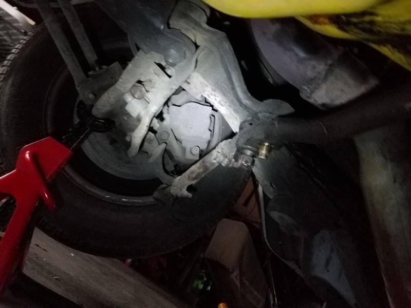

Hi all,

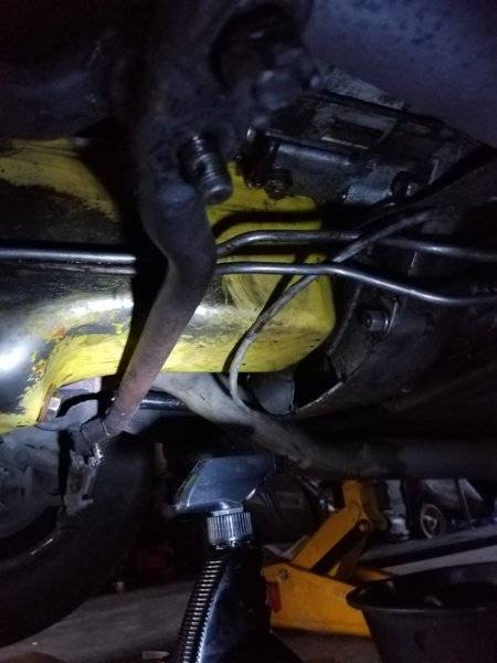

Is there a trick to this sway bar? steering linkage? Whatever that bar is that crosses right under my 360 oil pan. I would like to drop it without dying hopefully so I can get this oil pan gasket redone.
I read about just disconnecting the pitman arm and letting the bar hang but that thing isn't going anywhere. I pounded on this cross bar. I didn't try pounding on the pitman arm bolt because the thing is solid and still fully connected so that isn't going anywhere. I can't get a good angle to pound down on the bar. Would like to stick a flathead and pry the linkages but that'll damage the rubber parts.
I'm concerned that there's tension on the bar and when I drop it the wheels will flare out and the lower control arms will slide off the jack stands.
I'm also concerned I won't be able to force the steering linkages back in place.

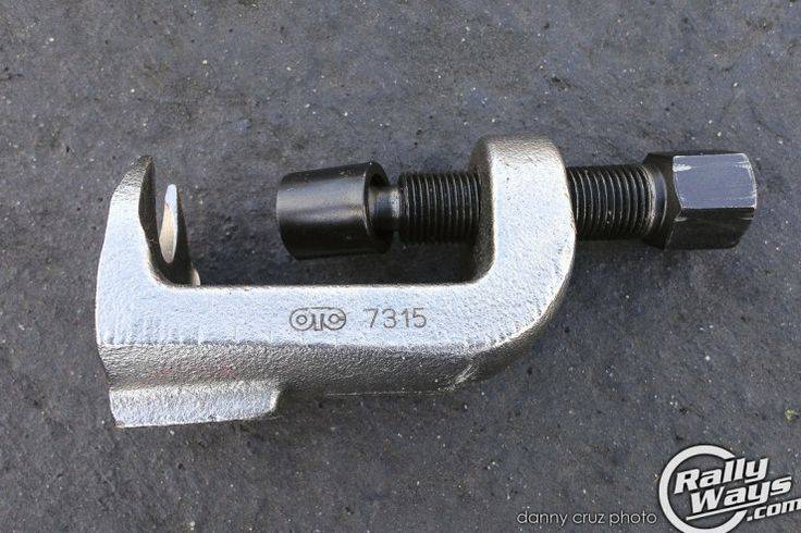

You need to go to your local parts house and rent a tie rod end separator or a ball joint fork to separate the tapered bolt from the center link.

That is the center link, not a sway bar.

So that's what those things are for. Alright guess I'll have to make another trip to the autoparts store tomorrow. Thanks for the vid.
Go by Autozone and borrow one. They have a tool loaner program.
I like this type:

Oh just that the center link seems to be under tension and I'm wondering if the lower control arms will shift and knock the jack stands over while I'm under there. I have the floor jack propped up under the frame just in case.
Center link is steering. LCA's are suspension.
They don't depend on the center link for anything other than which way to point the wheels.
The wheel/brake/hub/control arm assemblies pivot on the upper and lower ball joints, which aren't of course going
to move when you disconnect the link.
You might have to tweak the direction a wheel is pointing a little on reassembly, but that's about it.
no. it will just drop straight down. You need the right tool, if you have a harbour freight, you can buy a pittman/tie rod seperator cheap. You will have to do the same with the idler arm.
This is what mine looks like
https://www.harborfreight.com/tie-rod-and-pitman-arm-puller-63684.html
As an aside, I'm not a real big fan of where you've got your jack stand.
Perhaps on the reinforced frame behind the wheels?
Your not the only one, get those stands somewhere safe!!! I like putting the stands on the frame rails on a parallel surface (not where they curve upwards) and position them where the rail is in between the stands fingers so it captured. Think safety everytime you crawl under a car.
