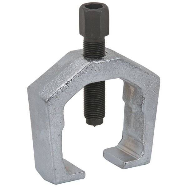

You need a Pitman Arm puller

Separated that linkage like a boss. First time doing one of those. Practice for when I replace bushings and boots later on. The pitman arm separator worked way better than the picklefork.

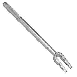

Did you try with this ? I have to replace the tie rod end in my delivery vans often is not so hard with the propper tools and beside this fork is really cheap
