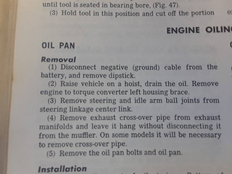

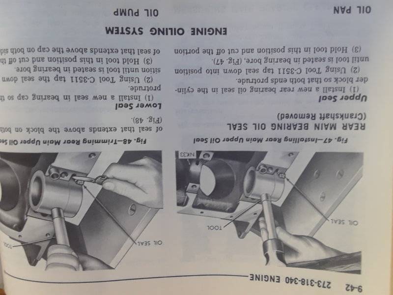

What does the factory service manual say the procedure is?
You DO have a FSM, right?
All I can say is, if you ever had a car slide off a Jack on you (happened to me) , or know someone who was killed by a car sliding off a floor lift, backup safety precautions are a good idea.

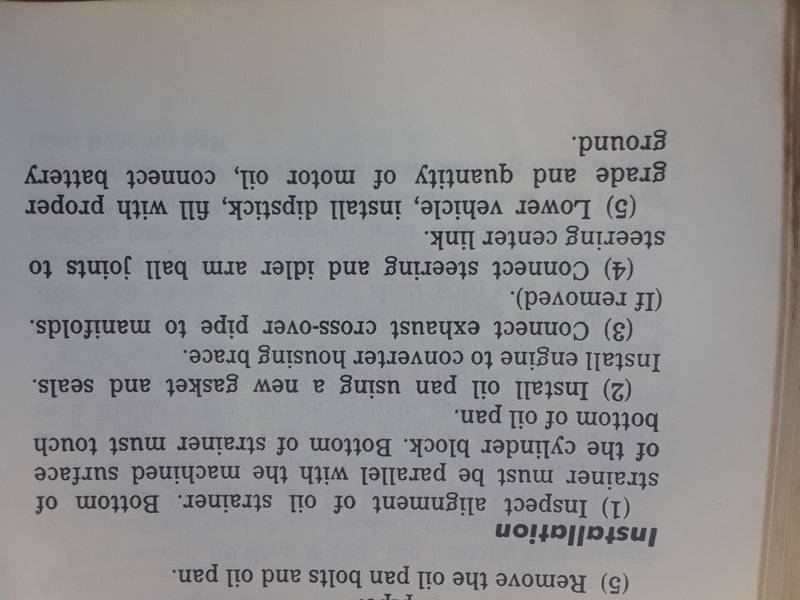

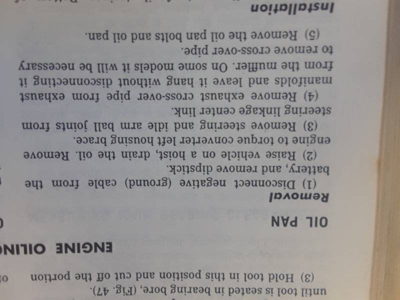

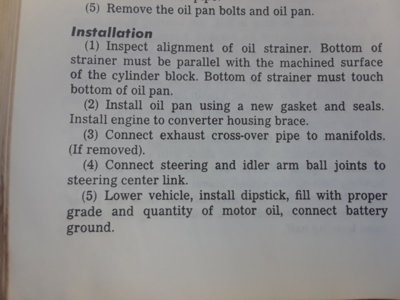

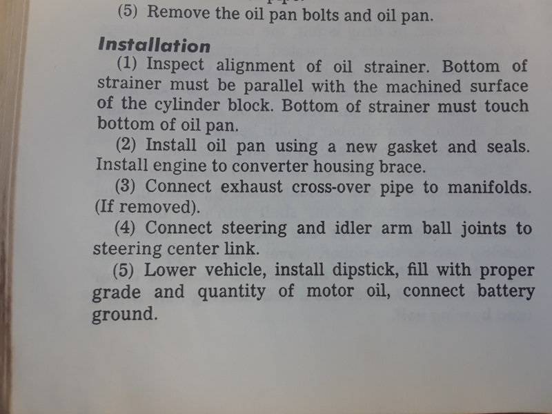

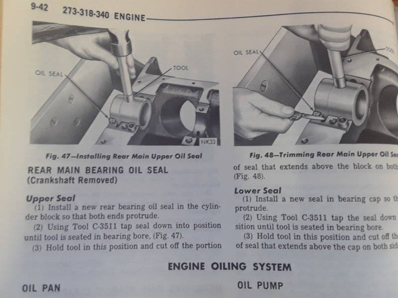

From my 68 factory service manual
I have the 73 (same 3rd gen b-body as a 74) manual and followed the oil pan drop procedure for the 360 motor. The write up looks exactly the same as the images you attached minus the crossover exhaust pipe removal.
I did skip "engine to torque converter left housing brace" . Did you have to do anything with this brace when dropping your oil pan? I didn't know what it was. I just removed the entire torque converter dust cover plate because it was the only thing torque converter related that I could see would help in the removal.
I couldn't find an illustrated parts breakdown in the entire manual that showed the engine to torque converter left housing brace.
