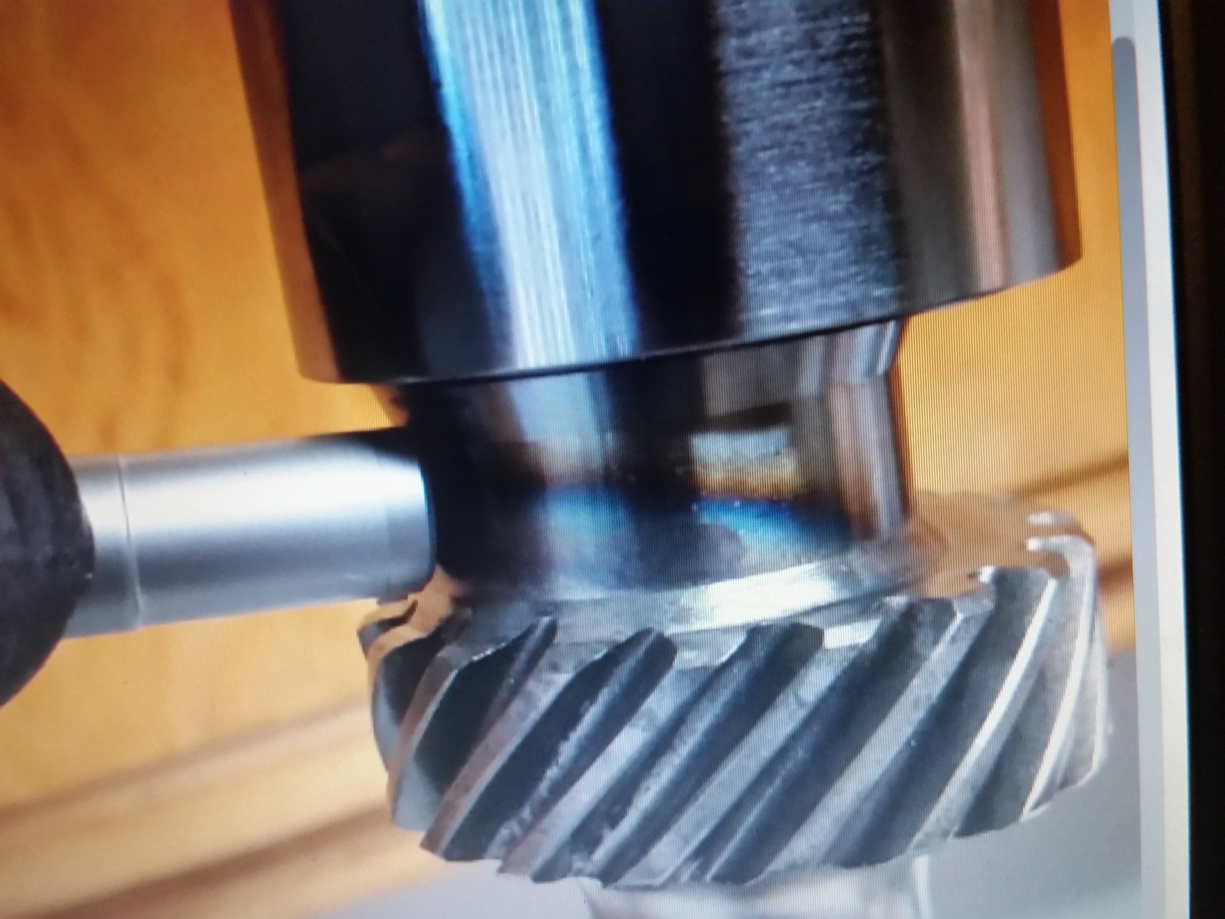

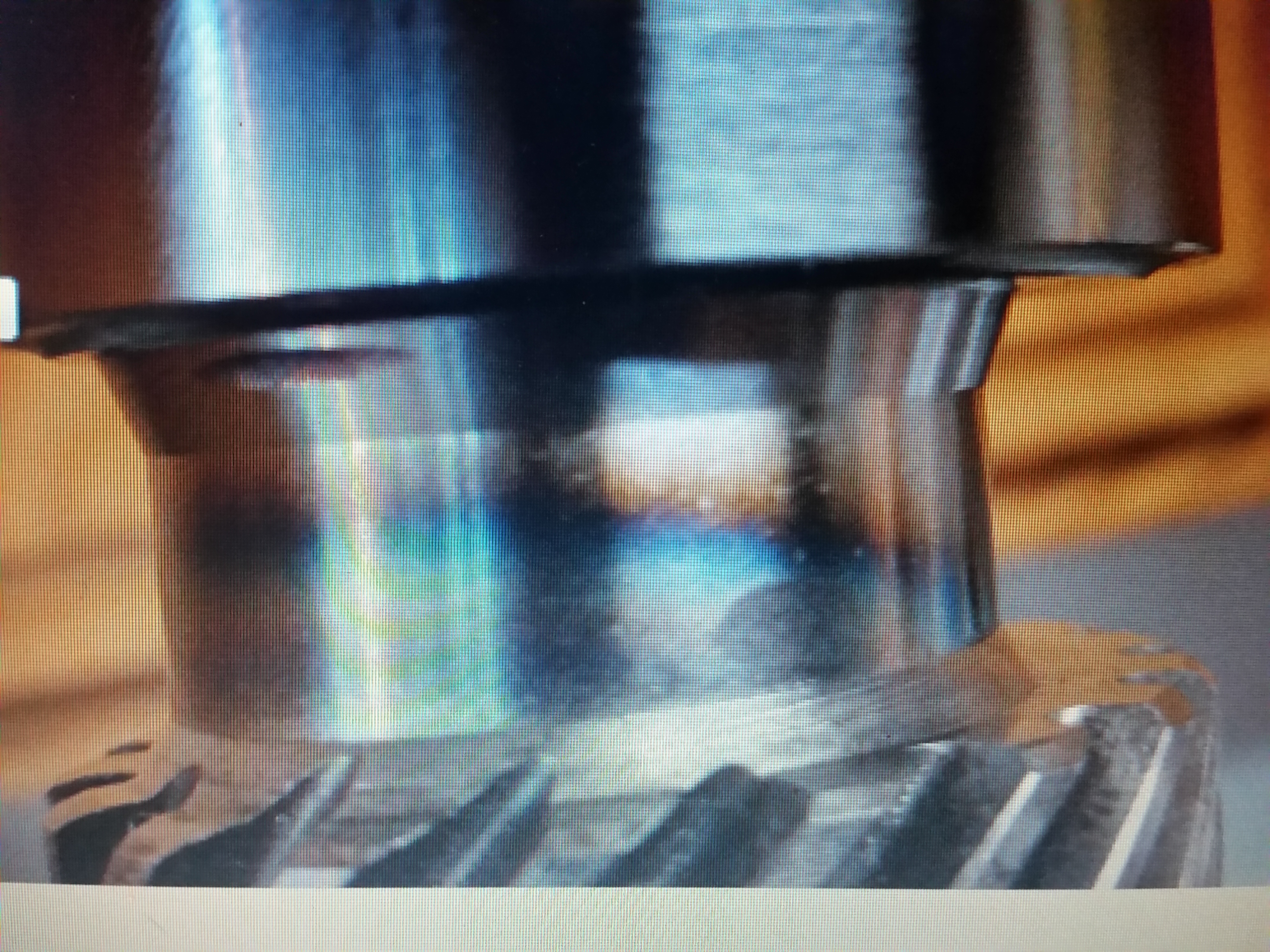

if you buy one look at it real close when you get it.
Howards makes Hughes Engines roller cams, i order one last year and the fuel pump part of the cam was miss cut, i sent it back for a new one. but it took so long to get, i ended up buying a Lunati Voodoo roller, and its pretty awesome. sold the Howards/Hughes cam on the forums.
that would probably be just fine.
thanks,what would that look like on cam so i can tell something is off? thanks,which lunati did you buy?
