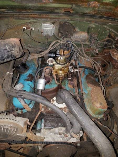

okay guys so about a week ago I was driving and my gas pedal stuck to the floor and took me for a ride. I made a thread about it here
http://www.forbbodiesonly.com/moparforum/threads/wild-ride-in-the-70-coronet.140029/#post-910798851
Now I got the car back from the mechanic and was driving it and I noticed that the car would slowly push harder and harder at redlight until I couldn't stop it. I got it home and threw it in neutral and it revved super high so I shut it down. When I got home the screw I marked in yellow wasn't touching the one I marked in green at all. Mechanic got it again and fixed the cable or whatever or adjusted it, long story short I finally get to drive it again and it starts to do it again ever so slightly. When I got home the marked yellow screw wasn't touching the marked green one. I had to get out and move it back. Everything is there but it seems as though it just won't go back to how it should when there's no power on here pedal. I included this picture and marked stuff in green and yellow because I'm not too savvy with exact part names cause I'm still in high school and it's my first car lol. Any help would be appreciated. I think it may be the return spring? But I never had trouble with it before or could it have something to do with the carb?

I'd start by spraying some carb cleaner all over the linkage. That'll help un-stick things. If your idle is too high, check for vacuum leaks. You could use a stiffer throttle return spring, but that'll make the gas pedal harder to push down.
As above , also make sure your choke is opening like it should & fast idle cam is moving like it should.
Yea it's just weird cause it was stuck on open throttle before and like half throttle also. Could it being gunked up really cause it to stick that bad?

I'd like to see a better photo image of where your accelerator cable is clamped. Doesn't look right to me in the photo you posted. Looks as though it's clamped right on the housing itself instead of the metal sleeve. If it's clamped on the housing itself that could cause the cable inside to bind.
Also, FWIW there should be a spring attached to your kick down (throttle pressure) rod for proper operation of your transmission.

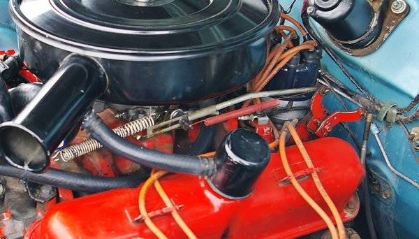

Pretty sure it should go the other direction - back to the pivot (if it's the same set up as what my '68 Coronet 318 car came with).
Pretty sure it should go the other direction - back to the pivot (if it's the same set up as what my '68 Coronet 318 car came with). If Photobucket hadn't gotten so stingy I'd post an image to show you what I'm talking about.

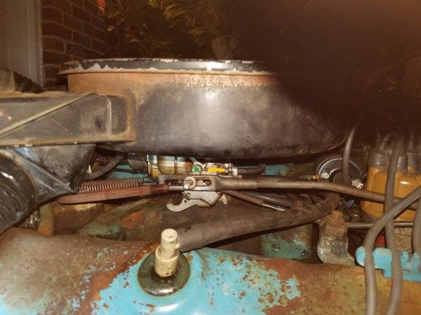

Huh. It's been like that since I got the car. Here's an older picture
The thing is, the way it's attached now it's acting as an throttle return. That smaller spring is there to pull the rod forward. I'm thinking the spring should go from the throttle stud to the other end of the rod, just above the pivot. I'm not suggesting this has anything to do with your sticking throttle, but it's probably affecting how your trans. upshifts.
Make sense?
Make sense?

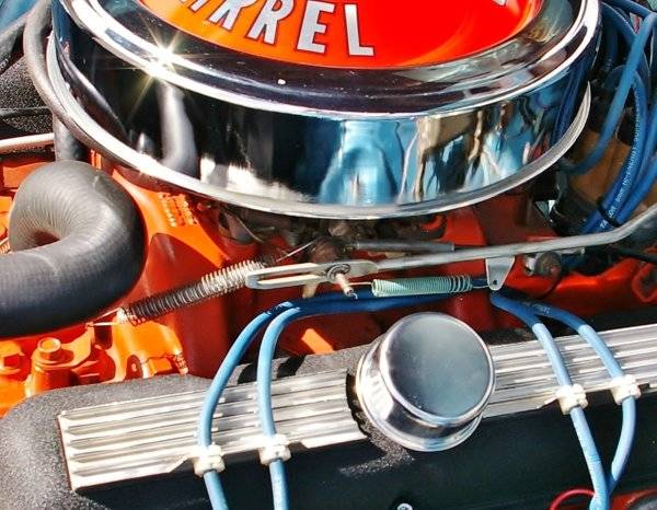

Here's a little different set up on the 360 that's in there now but you'll get the idea.
But again this is just related to the kick down (throttle control) rod. Not the main issue you're having.
