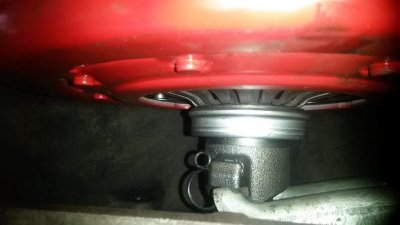

I have a 1966 Belvedere II, 273, 3spd manual. The old throwout bearing failed on a Sachs clutch, so I put a new clutch and throwout bearing in, from McLeod. Well, this bearing is failing after 300 mi. This clutch was SO jumpy, so I removed the return spring inside the cab. The pedal still returned fully, so I left it off. I don't think the release fork was riding on the bearing all the time.
When you press the clutch pedal down you can hear the bearing squeaking. The pedal feels rough as you depress and release it. I removed the inspection cover and it appears that the pressure plate fingers don't align correctly with the throwout bearing. I guess that's due to the bearing pivoting on the release fork.
You can feel a slight shaking in the pedal when the release fork contacts the throwout bearing - I assume that's because of the bearing pivoting. I rotated the engine thinking the pressure plate fingers got bent, but they appear straight.

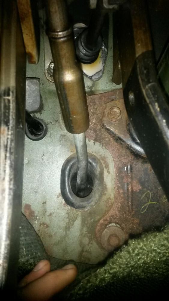

I know I have to pull the trans again to remove the bearing, but what should I look for this time? Pilot bearing on the trans? Also, should the clutch rod that goes from the clutch pedal to the bar mounted on the frame be bent? Mine is crooked where it passes through the floor / firewall.

I think I'd take a hard look at the fit of the release bearing on the trans bearing retainer. Also look at the fork pivot and make sure it's not bent inward possibly causing off center pressure on the plate fingers.
If your pedal rod mates flat with the torque shaft and pedal posts, and you're not popping the retainers off, I'd say your good there.

NAPA shows two release bearings, both are mated to the cast iron piece the throwout arm contacts. They differ in that one is self-centering - the picture shows a taper to the bearing face.

But is that tube part of the bearing retainer worn out and biasing the release bearing force outward? Is the fit too loose?
Don't forget the fork pivot condition.

I had the same prob on a 383 Roadrunner. Finally figured out that the bearing was contacting the clutch release fingers all the time. So the bearing was always spinning, wearing it out.
You still need a spring from the pivot arm to keep the throwout from contact when not engaged.

The input shaft bearing is under the bearing retainer that the clutch release bearing (throw out bearing) ride on. No leak or noise likely fine.
The link below has a couple pictures in post 7.
One clearly shows a bent pivot that evidently was causing the fork to slip off the release bearing spring clip.
Another shows the release bearing on the retainer. Looks like minimal clearance between the two.
