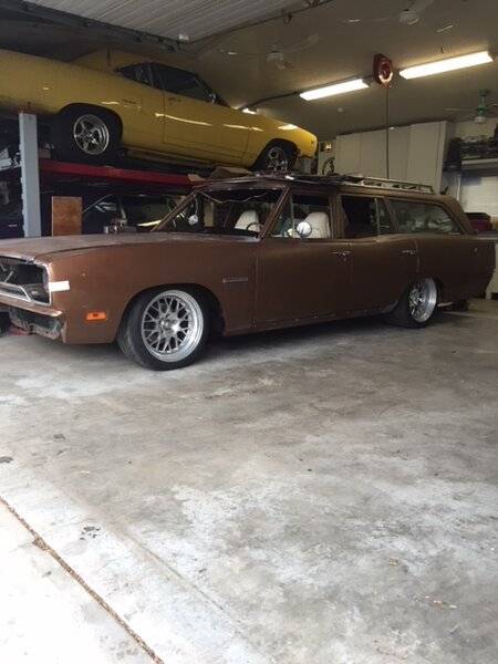

Doing a 2004 5.7 swap into a 1970 Belvedere wagon, using a Road Runner dash, will there be an issue to use the tach, will I need an adapter?
