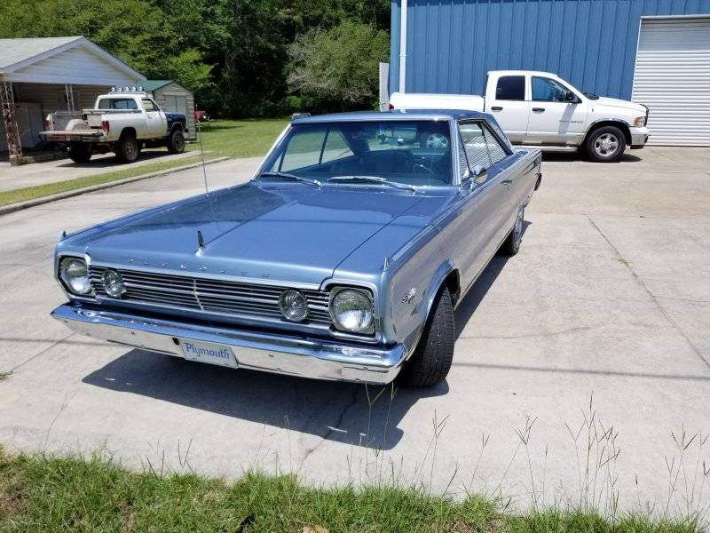

Doing research on swapping a Hellcat into a 1967 Belvedere. I want to use stock hood, anyone know if that will work? Open to different front suspensions to use stock hood.
2010 6.1 fits nicely under the hood. Stock K frame, slightly notched for A/C compressor clearance.
Very nice car!!! Any idea if the supercharger is taller than the 6.1 intake?
I don't know, but I wouldn't think so as they both fit under the Challenger hood. My concern would be the placement of the supercharger with the firewall components in our B bodies.
Got my 5.7 with hellcat blower and adapter plates to clear under the hood of my 67 Belvedere original small block k member, using us car tool adjustable mounts, manual steering, 727 trans and TTI 61hc headers.
